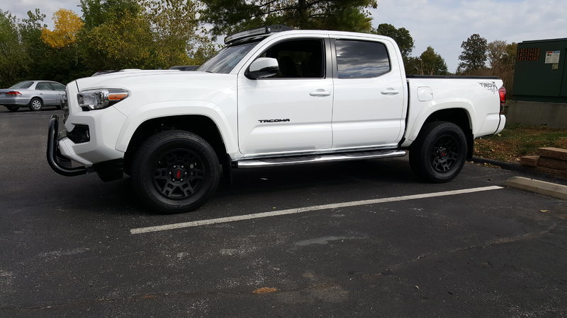

    See I actually did the install last weekend. Left on first notch and I feel like it didn't do anything. Still have a rake. 3rd Gen trd sport dcsb

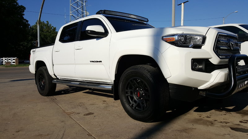

    just the spring that came with it. I believe they are the Bilstein 600lbs
    Stock suspension
    Bilstein 6112s on 1st notch, no lift in rear
    Highplainsdriftr likes this.

    Is that notch supposed to be 1 inch of life on the 6112? If so, that's the stock height for third gen

    Based on the 6112 being spec'd for the 2nd gen, I was able to get 5/8 on the driver's side and 3/4" on the passenger side with first notch before lifting the rears. These are higher than the 2nd gen, but provide the same amount of "lift" relative to original shock and spring set once you put them in as stated in the sheet that comes with the dampers. I'm 2WD and the front end is lighter on mine, so I still didn't get a full 3/4" - 7/8". If I can find the manual online, I'll post it here.
