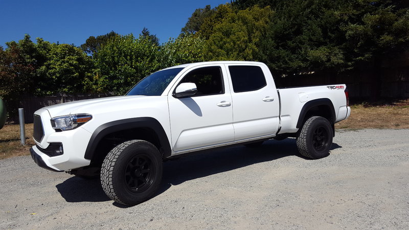

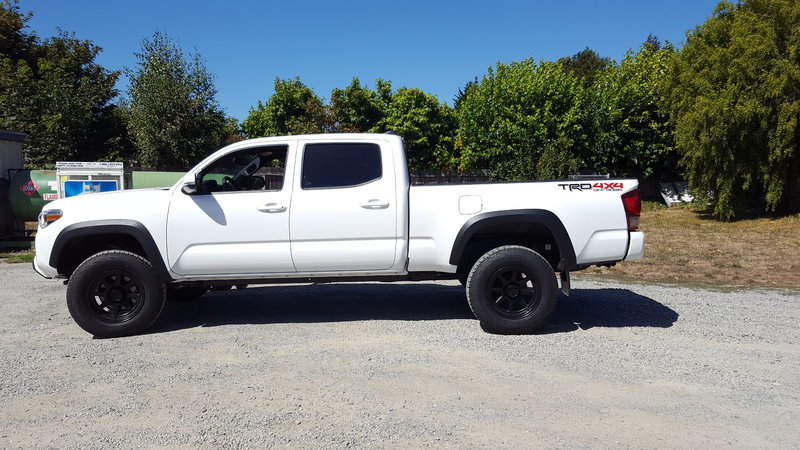

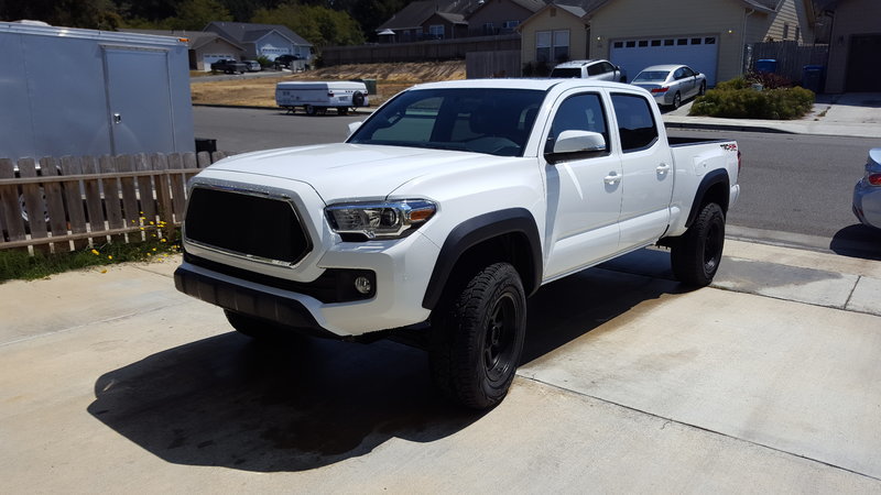

    16 TRD OR DCLB
    Bilstein 6112 front, 5100's rear with blocks, camburg UCA, 17" XD's with 285/70/17 AT 3's and a blackout front grille.
    6112's set at 4th notch (want to kick it up to the 5th notch when I get extra time)
    5100's in the rear with a 1.5 inch blocks (until I come up with money for some Dakar's)
    Love the ride, rear kicks like a donkey when going over speed bumps at high speeds but not too terrible. Got wrong wheels so there is rubbing but hope to remedy the situation soon. I like the rake but going up 1 more notch seems like it will still give me just a little less which might make it look more level from the side than it does now.
    6112's are killer, haven't experinced the 5160 but I am sure they are 1 step above the 5100's i have in the rear.
