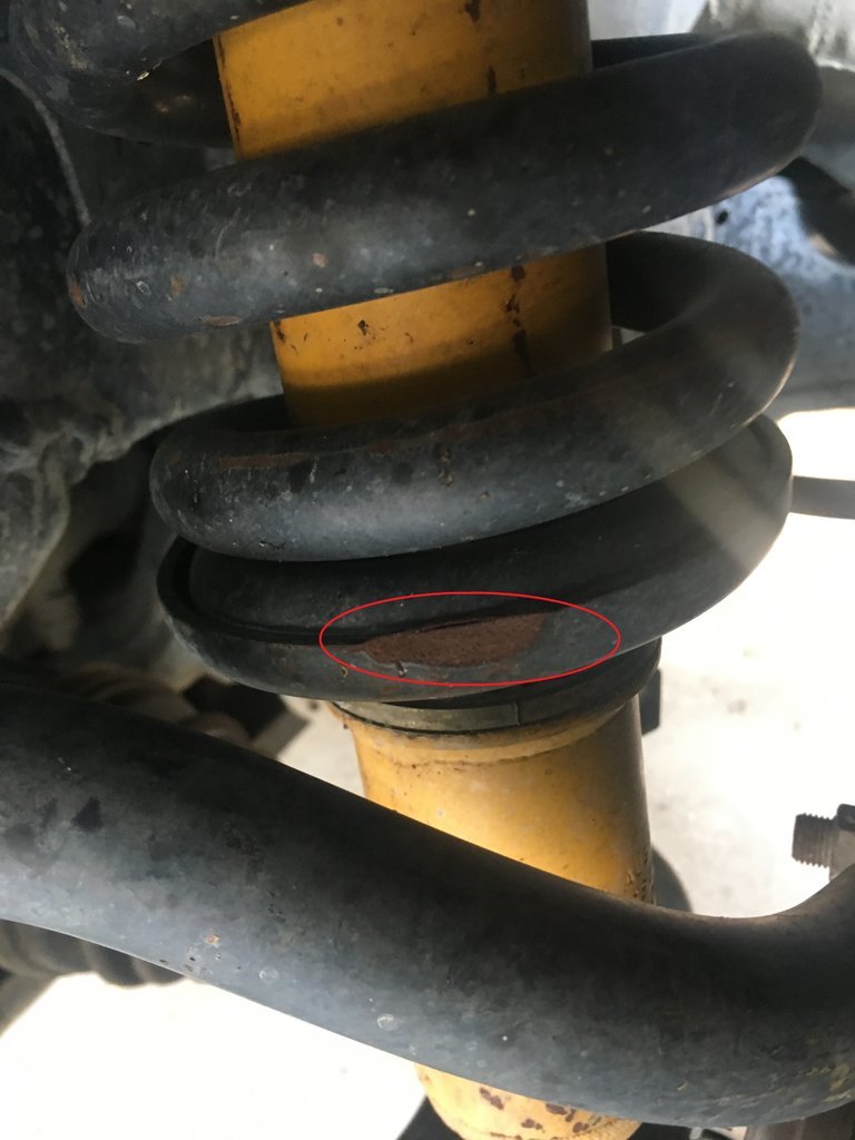

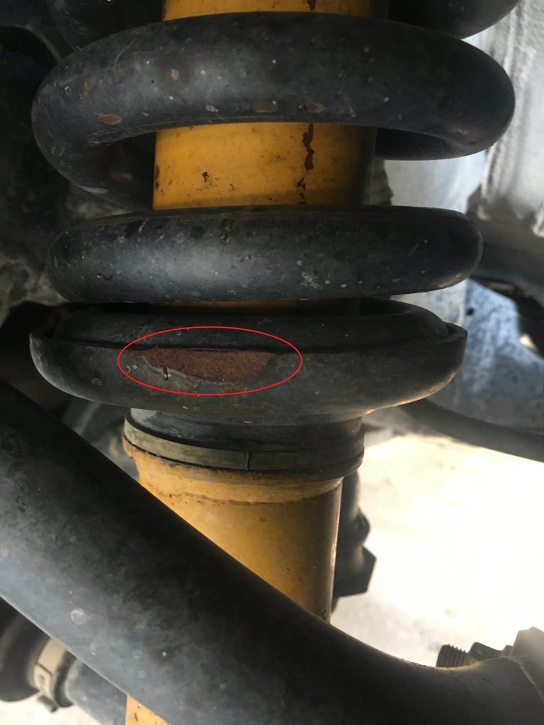

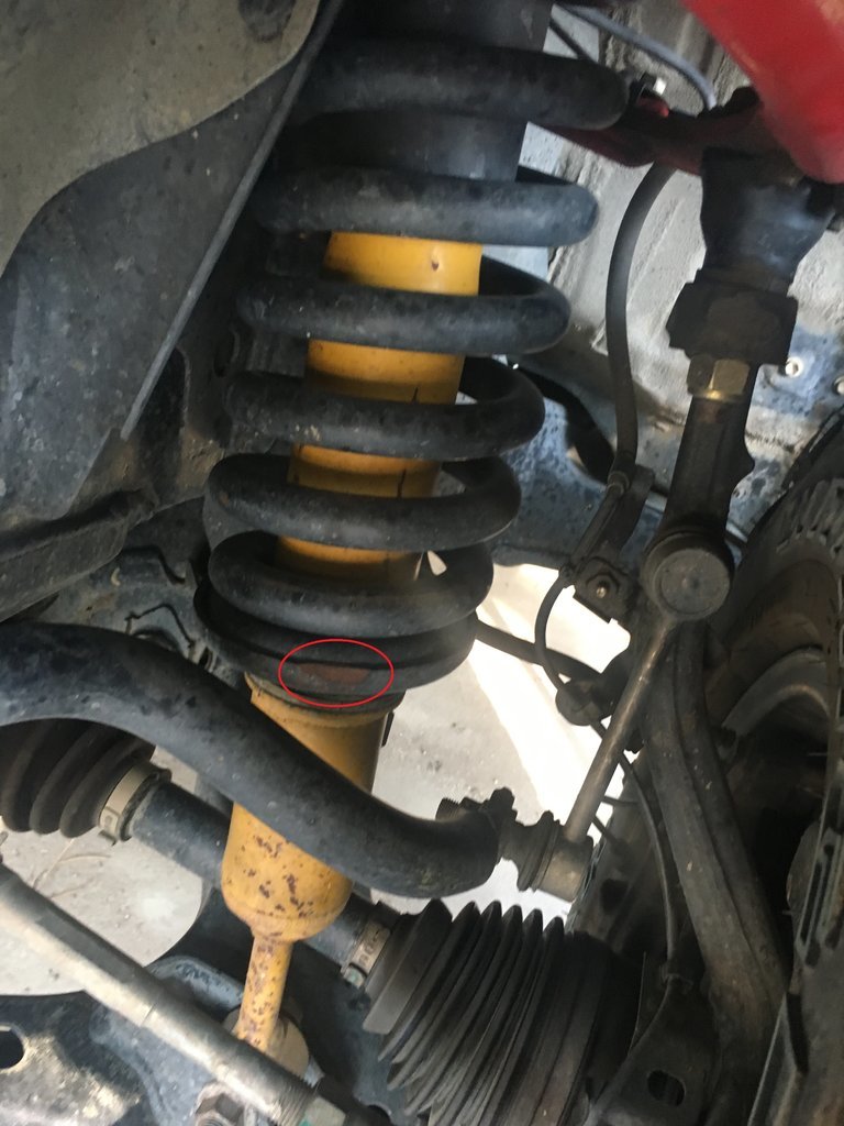

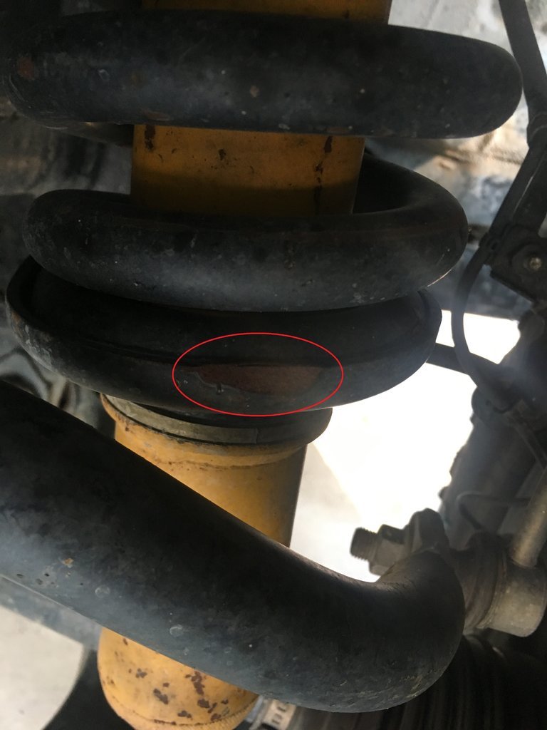

    Here are some pics....
    Found out my drivers side coil has always been hitting my sway bar since the lift has been put on. I have always heard a loud clunk going over speed bumps and this must be what it is. I have the OME 886 coils. Help me out with more info please. Thank You.
    Has anyone had this problem?
    What causes it?
    How can I fix it?

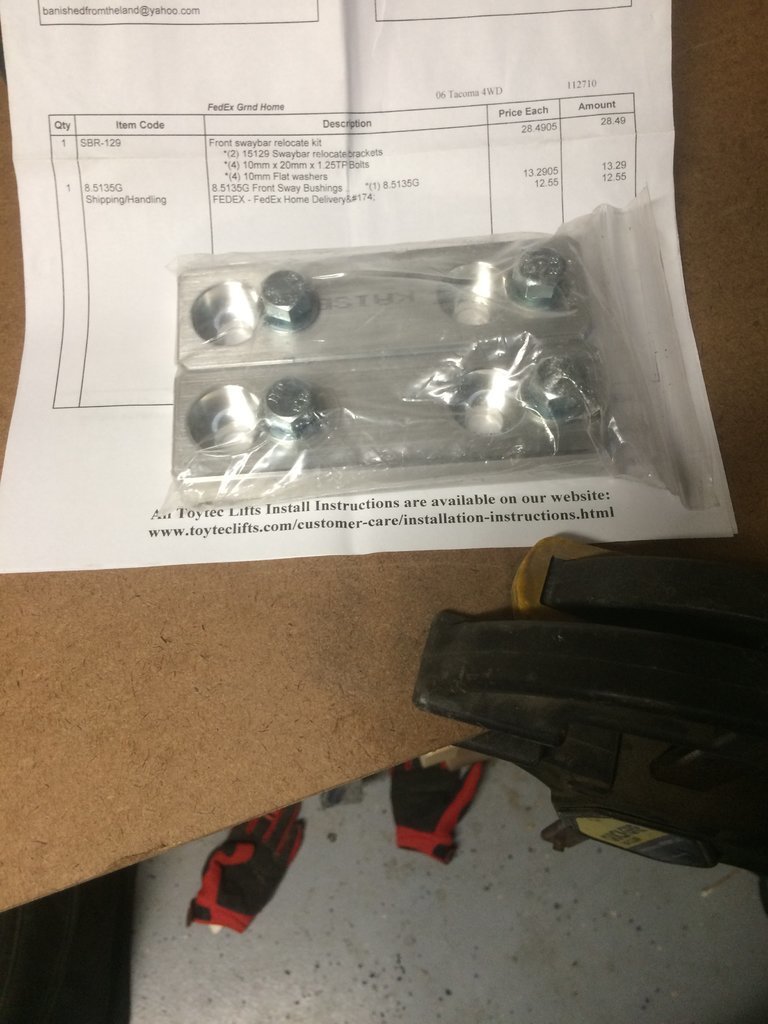

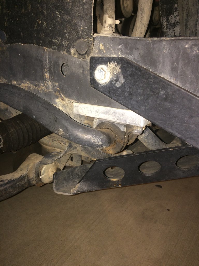

    image.jpg I'll do $15 plus shipping. sway bar relocation brackets. Never even opened the packet.
