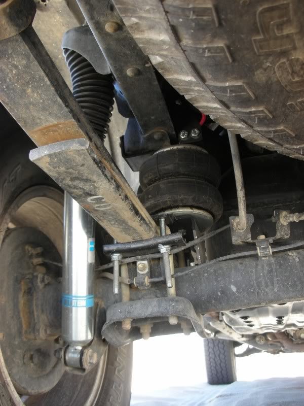

  20. Sep 29, 2010 at 10:28 AM
    #40
    David K
    David K Well-Known Member
    Jun 27, 2009
    #18969
    12,356
    Pala Mesa, California
    2010 4WD Off Road DC
    Differential Breather Mod Light Bar: 4 Cree LED lamps Bilstein 5100s Ride Rite Air Bags
    You should really do a search on this... tons have been posted on the 'harsh ride TSB' and how some of us solved the problem or made the dealer do the TSB (wish I had of, and could have saved the $800 it cost me to fix the soft spring issue).
