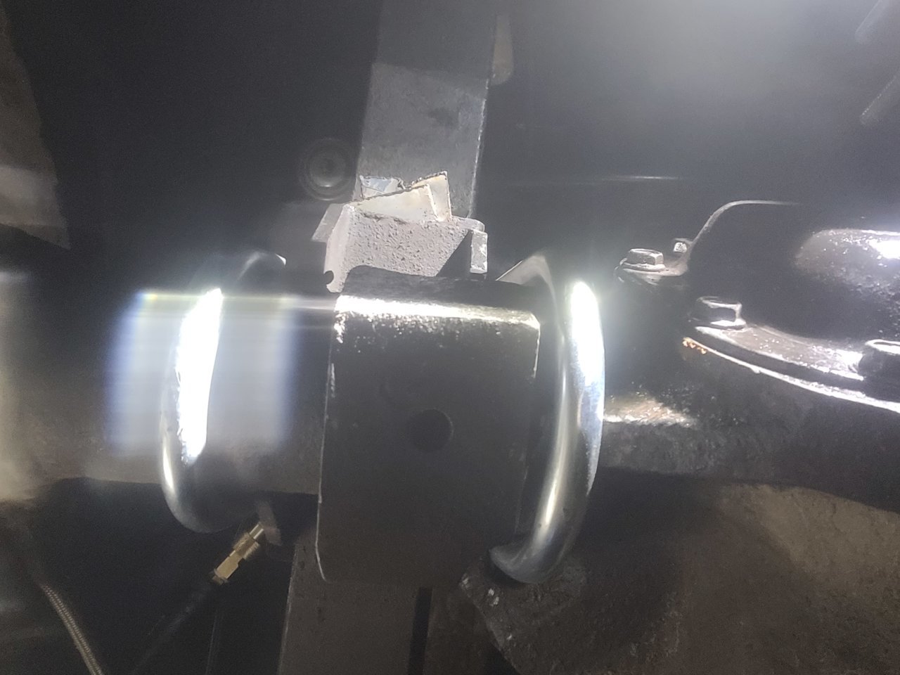

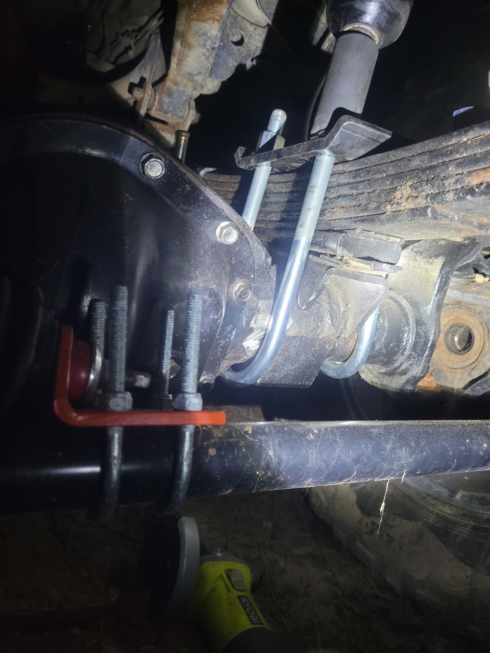

    Ok I was told my axle is out of a wagoneer would chevy inner axles fit or return them might be to late to do that though
  9. Nov 9, 2021 at 5:19 PM
    #29
    #T-coma97
    #T-coma97 [OP] Member
    Mar 21, 2021
    #360118
    24
    97 Tacoma SAS
  10. Nov 9, 2021 at 7:01 PM
    #30
    slander
    slander Honorary Crawl Boi
    May 10, 2013
    #103909
    8,964
    Hickory, NC
    02 Tacoma, fixed with curse words.
    Lol at those "shims" and leafs.
    That's common practice for a waggy axle as they came sprung under from the factory so you notch the factory cast perch for u bolts when you do an SOA on it.
    And for Christ learn what punctuation is so your posts are at least halfway understandable.
