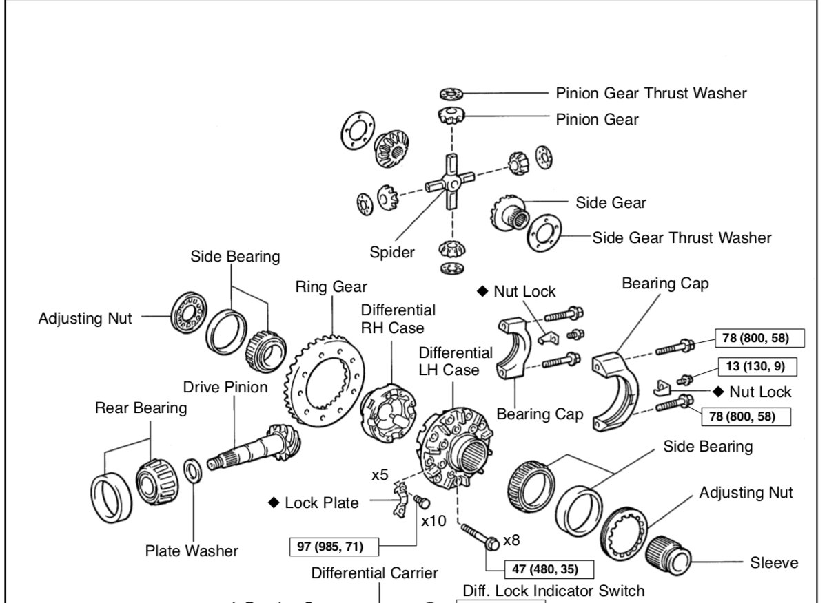

    Going back to a previous post of yours, when you say "spider gear shim" do you mean the "pinion gear thrust washer" in this pic?Screen Shot 2019-04-08 at 8.36.05 PM.jpg

    I would think so since there's 4......any slop on the spider and are all 4 washers in place?
    Remember, some here think you may be ok so don't go too far yet.
    Really though, I would think damage to be found fairly easily, these things don't last long when out of jive.
