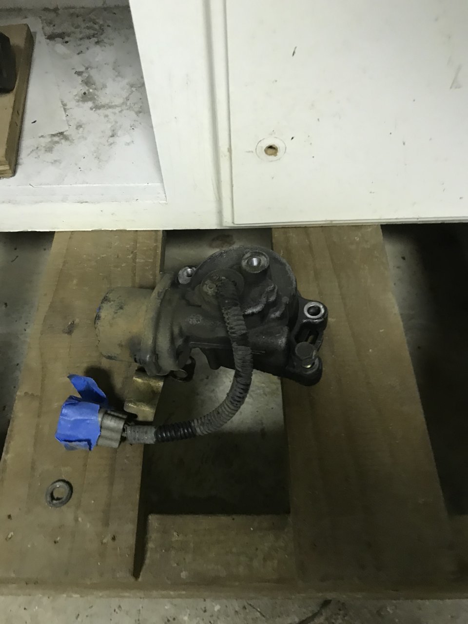

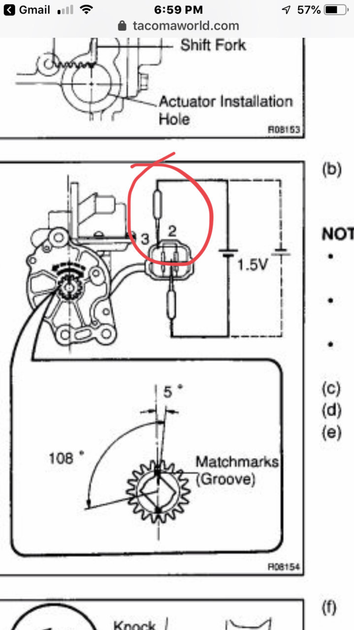

    A few questions.
    1) Where does one get those electrode things (no idea what they're called) that are stuck into the harness?
    2) Does polarity matter when placing the electrodes in position 3 and ?5?
    3) Are the match marks already on the pinion?
  13. Apr 11, 2019 at 5:00 PM

    These are terminals?

    But for testing purposes, I could just use any wire, correct? Those things I circled look like the things on a voltmeter

    Use wire with the ends stripped

    Thanks man. You're my rock. You're my soul. You've been my guiding light down this dark differential tunnel.

    He needs to power the pins with a 3v battery

    I already have spare wire and a couple of batteries lying around

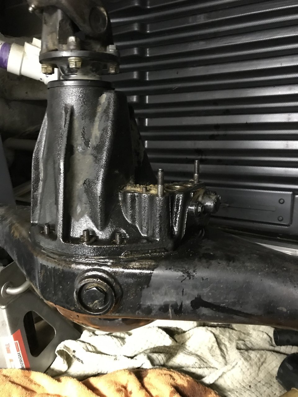

    E locker actuator is off, third member is unbolted, but I cannot get the damn thing off. I get it pulled 98% of the way and it catches on the top pin! I’ve lived it with gear oil, hit it with PB blaster, and verified that nothing inside is getting hung up!
