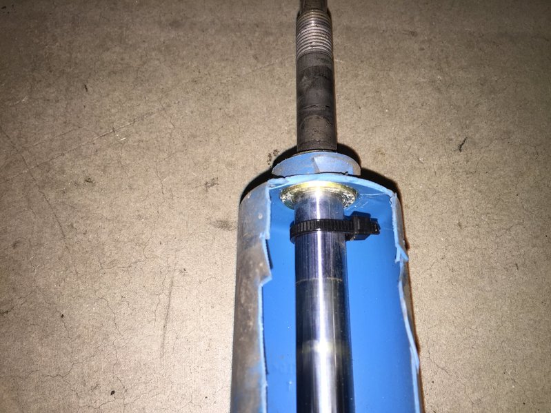

    This depends on the size of the spacer. In stock form your bump stop will hit with about 1.5" of shock shaft left.
    This is how much of the shaft isn't being used with a 1" thick spacer(providing 2" of lift) on the stock Bilstein shocks:
    I can see the people with the 3" lift spacers having issues and snapping shocks if they don't space the bump stop down appropriately.
    I ran spacers for years on several different vehicles and never had any issues. I never noticed any change in the ride either. I see nothing wrong with them for people who don't off-road and just want to level their truck. I wanted more performance out of my suspension so I eventually opted for aftermarket coilovers. Spacers worked very well for me though. Hundreds of thousands of miles later and no broken shocks.

    Thats not a coil over though....Also yes you can space the bump down, however, then you have even less wheel up travel and bottom out sooner.

    Huh? That is the factory Bilstein shock from the front of a 2005 Tacoma TRD. Yes, it is a coilover.

    Sure looked like the rear shock at first glance.
