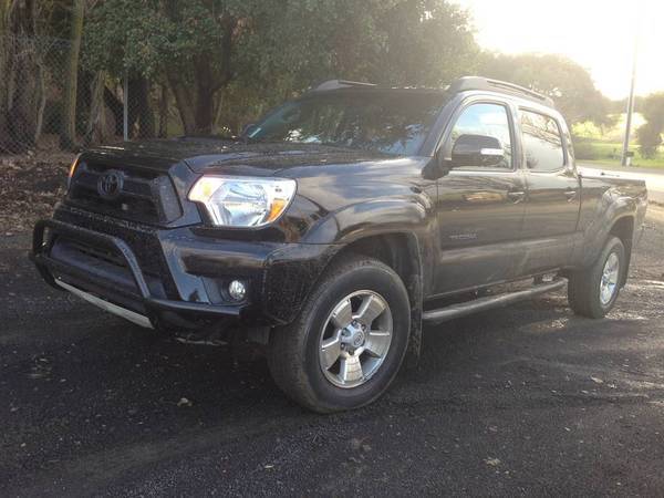

    I have had my 2012 prerunner acouple months now. I blacked out the badges, added the roof rack, skid plate, steps, and avid bar. I would like to make the truck a little taller. Just for looks. I wont be offroading so spending 1000 + for a new suspension doesnt make sense. I know this topic has been beaten to death on here but I would like to hear from a few people who have spacer kits. Please dont just bash spacer kits if you havnt had one.
    Im considering the Fabtech kit below. I dont want to preload my suspension. so I want a Top spacer.
    http://www.extremetrucktoys.com/tacoma2.html
    Before:
    After: 5100s on 1.75 with 265/70/17s

    Im getting 5100's on the front tomorrow to bring it up 2.5 inches to match the back at 4wheelparts. Im thinking about doing rims and tires at the same time. Does anyone know how big I can go on the tires with only a 2.5 inch lift on the front? Also if I stuck with a 265. but went 265/70 or 75/17 could I still use my stock spare 265/65/17?
    Thanks
    After:

    Overall, the biggest you can go without trimming is 265/70R17. You can go taller if you go skinnier or start messing with different backspacing.

    pretty sure you can do 285 with that lift. needs some trimming and new rims or spacers on the stock ones. rubbing will be minimial on your mall crawling expeditions.

    I'm running 275/70/17 (32.4") with my setup, with no rub. I'm right around 2.5" of lift. Also you could run 255/85/16 or 255/80/17
