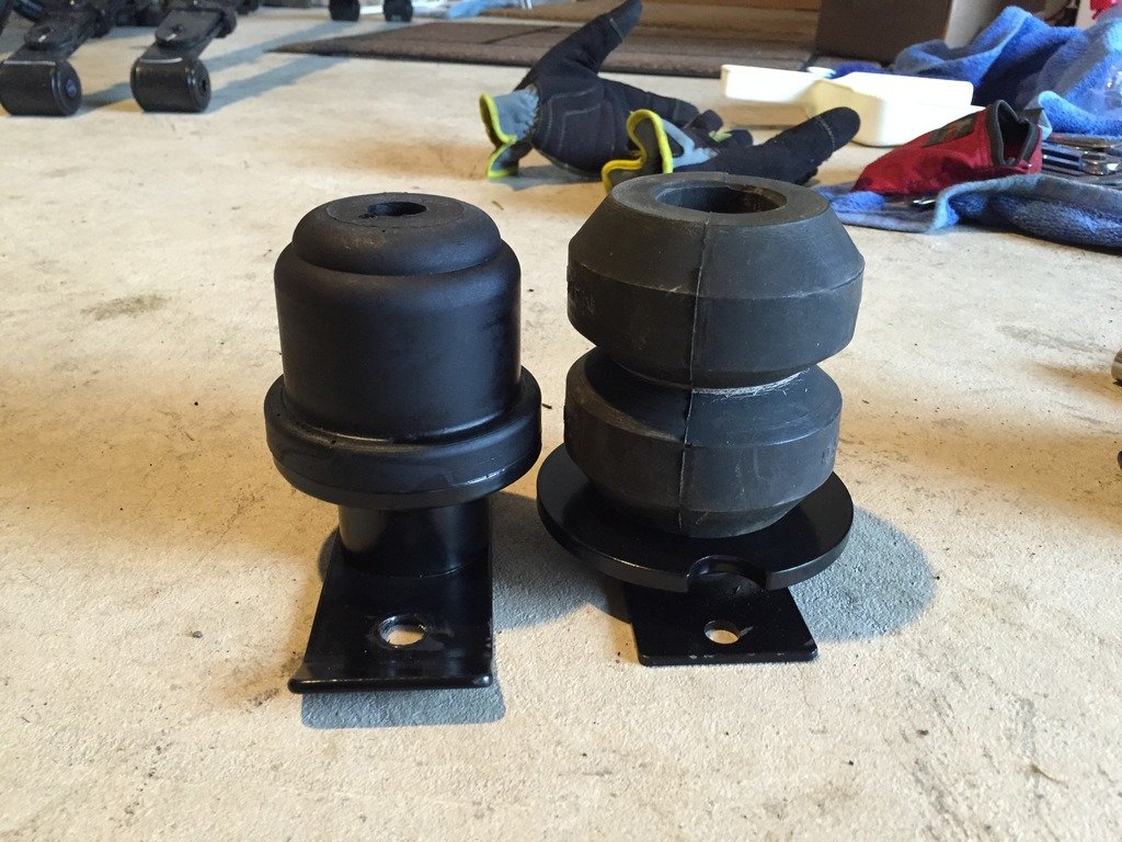

    What part number did you order for timbrens? There are a couple options for the tacoma, and tons of "spring" options for timbrens.
    I have 6.5" between the frame and the timbren mount. So I'm thinking I'll order different timbrens that are just over 5" tall and use spacers. I'm just trying to decide on which weight capacity to use. Probably either the 1800lb or 2800lb version.
    Comparison of the wheelers superbump and allpro timbren kit side by side if anyone cares.
    I definitely could use just one of the brackets and swap the bump stops. The soft all pro timbren seems softer than the superbumps which was a little surprising. The front superbumps feel amazing over rough terrain, but I haven't tested the rear since I don't have longer rear shocks yet. I'm suspecting the timbrens may actually be a softer bump for the rear but we'll see.

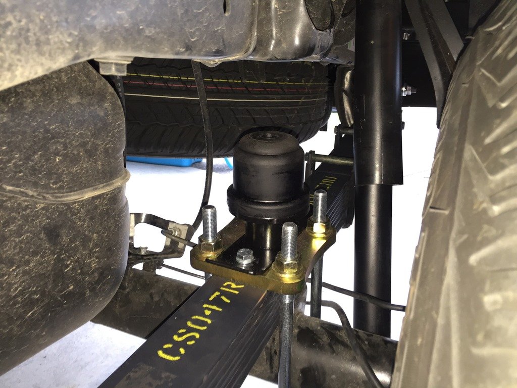

    Not sure who you were asking but I got the TORTUN4L which is the HD version. I just finished driving around for a few days on a short trip with the camper and I am pretty happy with the density of the bump stops but the shocks don't have the dampening power to handle the weight very well. Good enough for now but definitely changes coming in the future.
    Thanks for the side-by-side comparison. The mounting bracket on my Timbrens actually looks more like the one on your Wheelers'.

    Yeah there are a couple different timbren options for Tacomas so that answers my question.
    I'm guessing that the wheelers superbump bracket was a timbren bracket or copied. Designed to work with the U bolts in the factory location. I drilled the plates to match the all pro u bolt plate. The timbrens from allpro compress easier (by hand or foot) than the superbumps, but I believe are only 1000lb rating.
    I just order new timbren springs. Went with a535-55. They are 5-1/8" tall 1800lb springs with 3-1/8" max deflection. I have 6.5" spacing from frame to bracket so I ordered 1/2" spacers too.
    The timbrens in your kit are 1500lb rating but but only 2-1/4" max deflection, with 65 durometer rubber. So the timbrens I ordrered have a higher load rating, but in theory would be softer (lower durometer rating) and would have more "travel". Unfortunately im still probably 2 months out but I'll let you know how it works.
