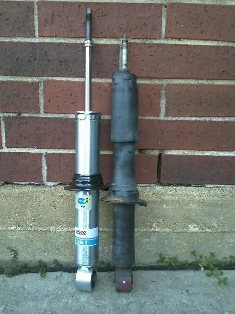

    Did anyone have trouble with the 5100 being too long in the front?

    Deltona, Florida
    too long?
    How?
    As in the shock itself too long, or giving too much lift?
  16. Jan 22, 2012 at 3:30 PM
    #36
    Adam Baum
    Adam Baum [OP] Well-Known Member
    Jun 13, 2011
    #58194
    289
    PCS
    01 PreRunner SR5 debadged
    the Bilstein 5100 shock itself is about 1/2" longer than the OEM ones. Been on this thing for 2 hours and can't figure out how to get it in there.
    Also which height setting should i go with? I got the 5100/881 combo for the ARB bumper (w/o winch).

    Never heard of them being longer...maybe you should double check part #'s
    where did you order them from?
    And is it the shock body or the dampening rod that is longer?
    Use the "0" postion if you are using lift coils. If you dont your ride will be unbearably stiff.

    ordered them from DSM. The part number matches their "4" Bilstein shock package.
    Finally got the front shocks on. The Bilstein PDF says that they are built 1/2" to 3/4" longer to prevent over-extending the suspension. Now on to the rear....
