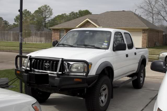

    That's good to hear! Post some pics!!!

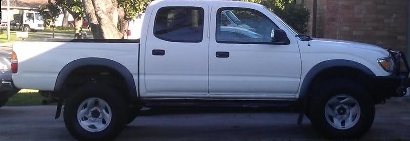

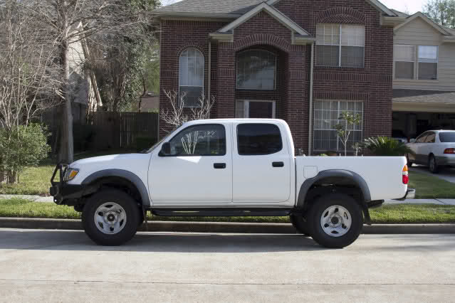

    Here is a cell phone picture (HTC Sensation 4G if anyone cares) of the truck as of yesterday. The rear is currently set at 50psi. It looks good, but I'm trying to not ride around on that much air pressure. I will try and get more pictures sent today.

    If the front settles to about 2'' of lift, then the wheelers 5 pack will have you sitting about level. Remember these trucks have a factory rake, with the front end about an 1'' lower than the rear.

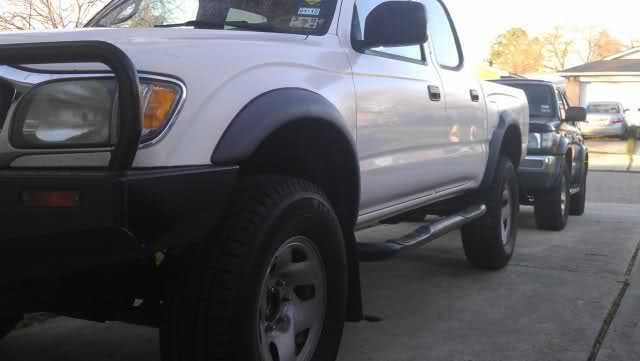

    Here is a side picture from today. I like the look alot, now I just have to find the right suspension pieces so I can deflate the air bags.

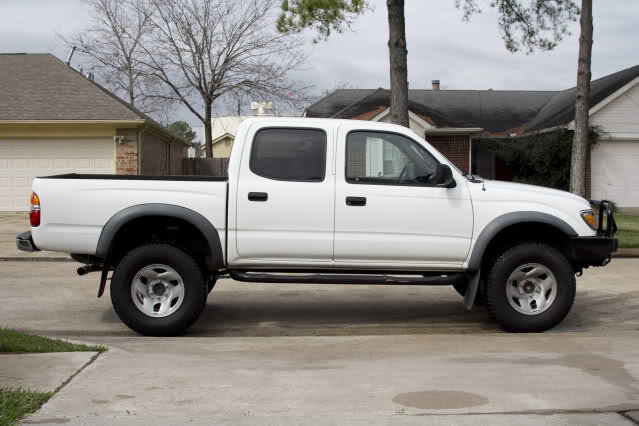

    front = OME 881/ Bilstein 5100/ ARB bumper only
    rear = stock rear leaf springs/Bilstein 5125
    tires = Firestone Destination LE 265/75/16
    Firestone Ride-Rites @ 50psi
    Firestone Ride-Rites @ 12psi
    Will update once the Wheeler's 8pack is in.

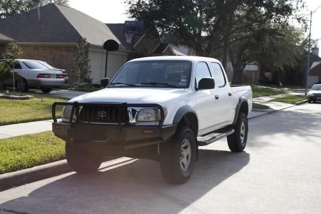

    After the Alcan 8 leaf install.

    so the pic says you just got a leaf pack?????but you still wanna rebuild im confused
