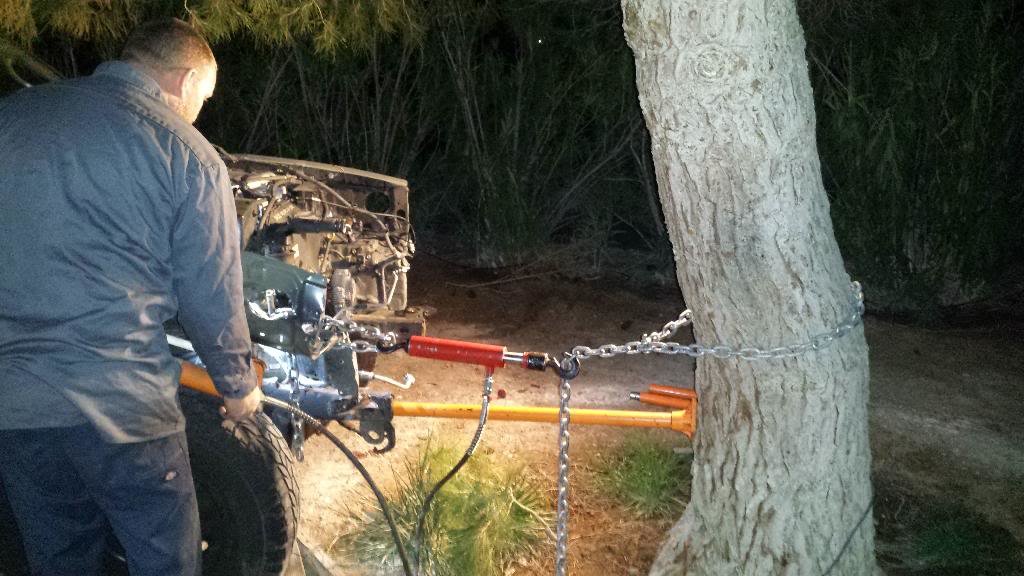

    So a friend's mom rear ended a car, insurance totalled the truck.
    This is how I picked her up
    [​IMG][​IMG]

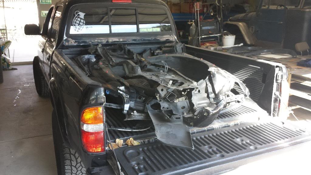

    And within 3 hours at my house all the busted parts removed and new parts list created. This puts my Toyota count up to 4. :D

    Thats going to be my brothers job, but some what we came up with we will weld/bolt some plates on and pull it out using the big tree out front.

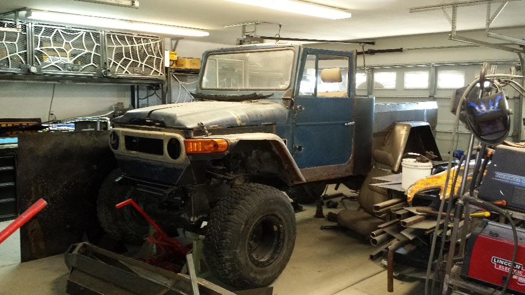

    Thats my brothers 40Runner. 4Runner modded frame/motor/tranny, 70 FJ40 body going to look something like a Wider FJ45 with IFS rolling on 42'' tires.

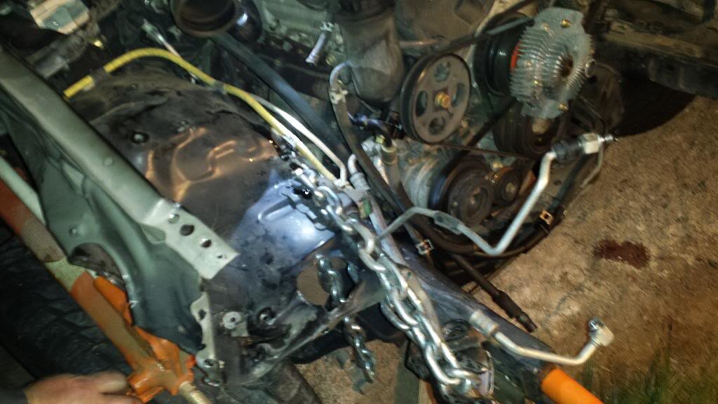

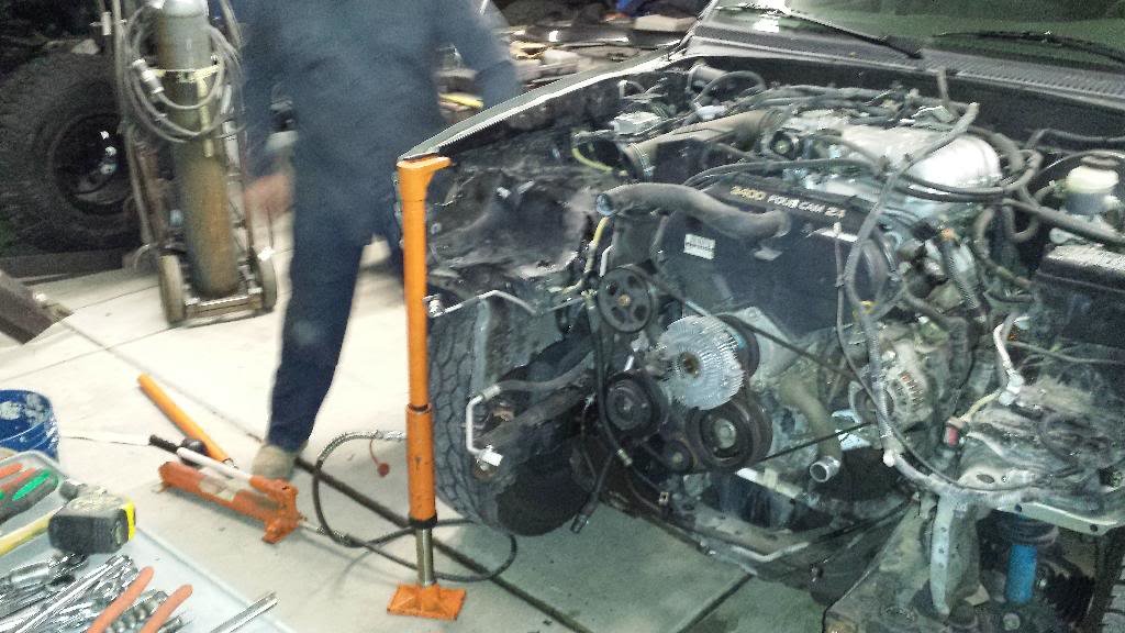

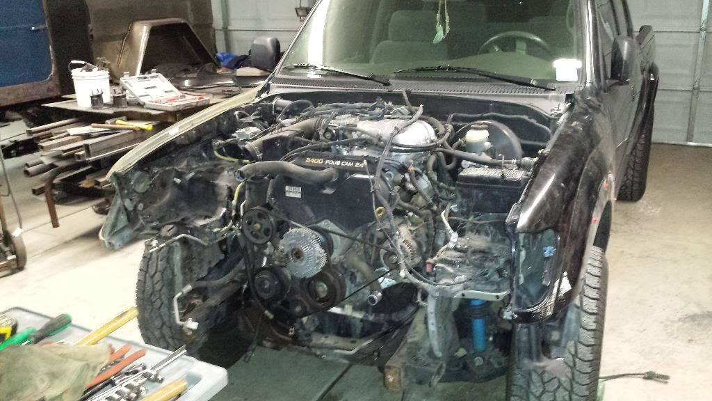

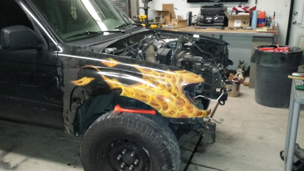

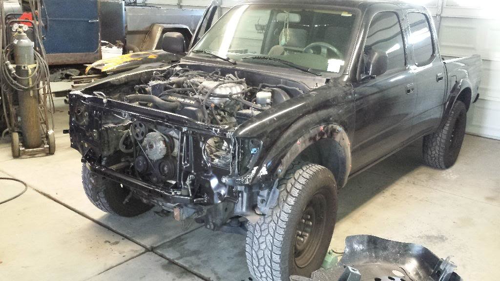

    Heres a few pictures how we did it, still a few more bends and tweeks to get it right, but its come along way from being smashed into the tire and UCA/Shock.
    LUCKY we just happened to have a spare 02' Passenger Fender just laying around my brother used to practice paint on. Now to order a New Front Core Support tomorrow.

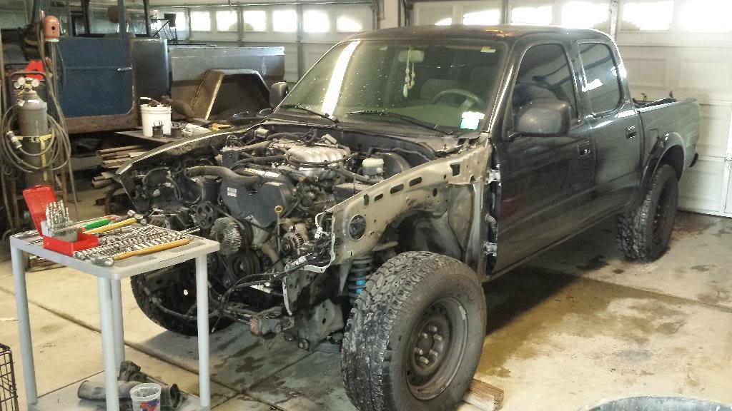

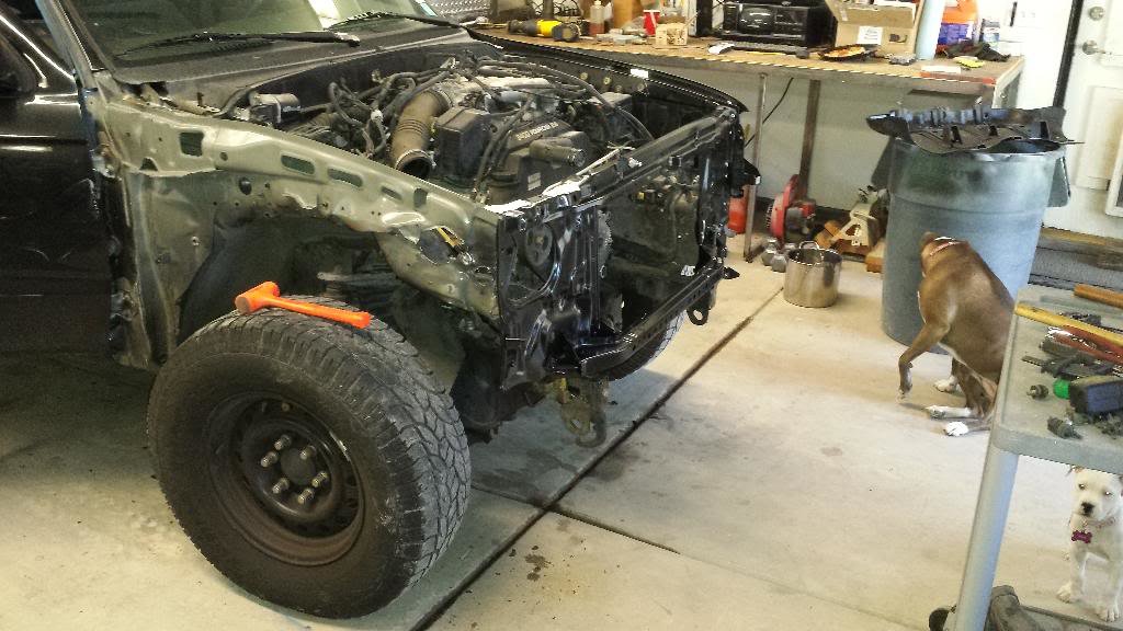

    Got the Core support in place and bolted to the un damage driver side. Now just to tweek the other side till it fits.

    Heres a better picture of it for your view pleasure.
