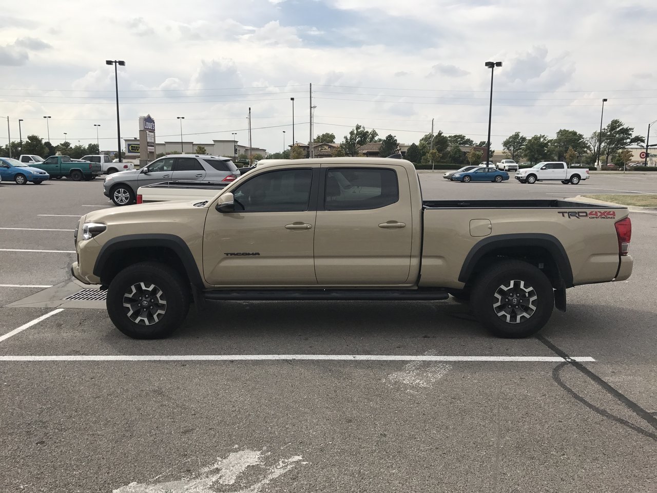

    You can go up to 887 which might push you into needing new UCAs to get a decent alignment or stick with 885 and live with a small amount of rake. If you tow that much your now level truck will eventually develope a nose up lean.
    Here's my truck with 885 and 3 leaf AAL with overload left in, I still have the stock rake but goes level when loaded.
