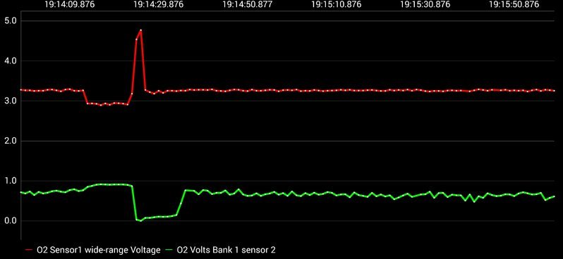

    I'm trying to figure out my p0420 code. What kind of range should I see out of the af sensor? I was watching it on my way to work this morning and it ranged from 3.23v-3.29v.
    I checked my cats with a temp gun. And the upstream seemed to be working correctly. Cooler temp at the inlet hotter at the outlet but the downstream cat was basically the same temp in and out. The downstream cat is just over a year old with 20000 miles on it. It's a MagnaFlow cat.

    Here's my graph doing 55 for about a mile and a half. The spike is where I let off the throttle for a second. To me it looks like my a/f sensor doesn't look as it should. It is a brand new denso.
