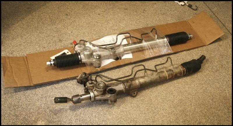

    Steering rack swap is finished. So far so good. The Safari LTD rack looks to be a solid piece. Time will tell if it's truly better than other aftermarket options.
    Got the alignment all done, and steering feels really good. Next up is replacing my trashed spring bushings. Ordered new ones today and should have them swapped this weekend before our trip to the dunes.

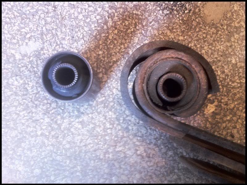

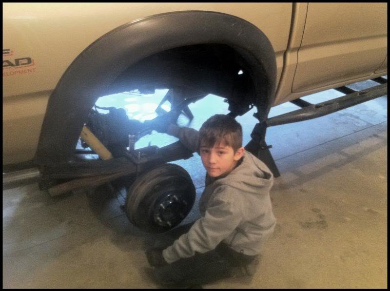

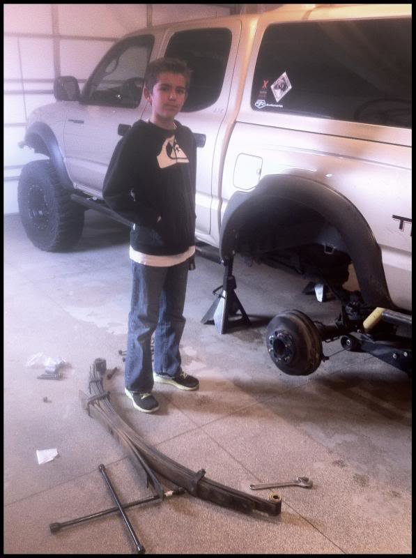

    one of the cool thing about having boys that dig trucks is that they'll come out and work on them with you. My boys learned how to replace spring bushings today.
    The eye bushings were totally disintegrated. Here's a bad one with a new Toyota bushing on the left.

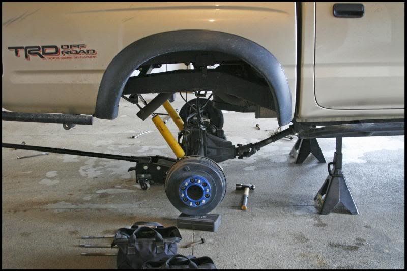

    a couple non cell phone pics of the springless truck

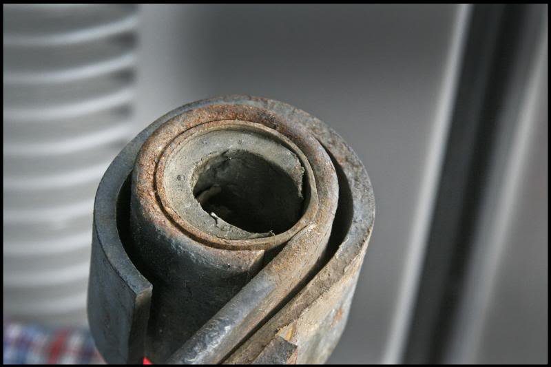

    this bushing was so bad the inner sleeve fell right out when we got the spring out.

    What makes you think they went bad so quickly? Just a rough life?
  18. Feb 1, 2014 at 7:27 PM
    #2098
    Box Rocket
    Box Rocket [OP] Well-Known Member
    Mar 1, 2010
    #32389
    7,184
    Adam
    Syracuse, Utah
    1995 FZJ80 Land Cruiser
    3xLocked, lifted, well used
    3+ years of hard running.

    Wow, makes me wonder how long they would have lasted without the zerks to grease them!
  20. Feb 1, 2014 at 7:31 PM
    #2100
    Box Rocket
    Mar 1, 2010
    #32389
    7,184
    Adam
    Syracuse, Utah
    those don't have zerks. That is the eye on the frame end. It uses a factory toyota bushing and bolt. There's an inner and out sleeve. It's common for the bolt to seize to the inner sleeve and then all the rotation is forced into the rubber and it will tear apart.
    Mine weren't siezed at all but they had just been run hard.
