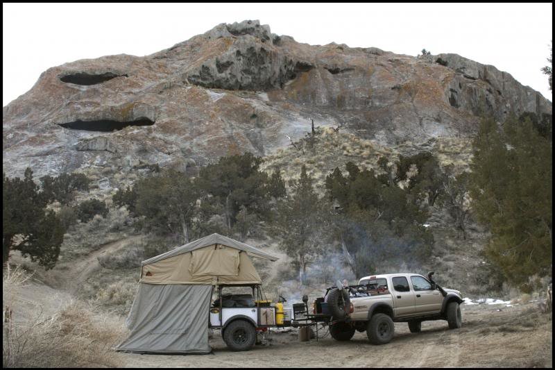

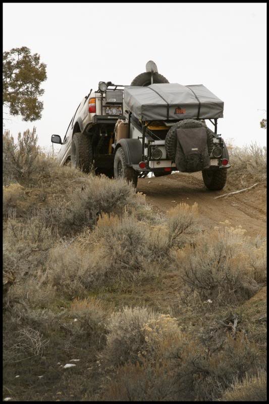

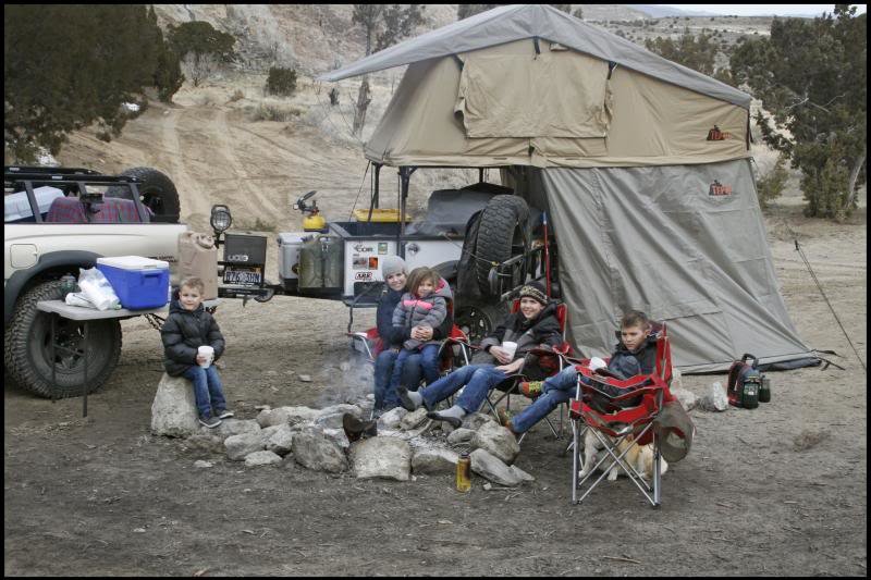

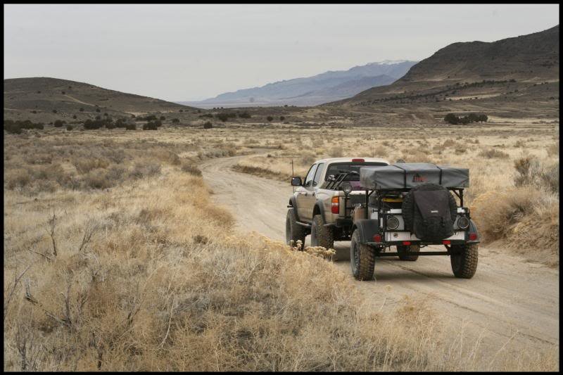

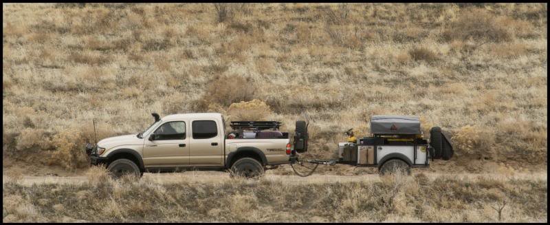

    Got to load up the trailer and the truck and head out for a night of camping with the family. I was a little worried about the kids camping in February in Utah, but the weather was not as cold as it usually is this time of year. It was still chilly last night but it wasn't bad. There was a killer full moon that made it feel like daytime all night. It was spectacular.
    Here's some pics.

    looks like an awesome trip! love the setup!

    Looks sweet Adam, where's that located?

    White Rocks
    Yeah, 35's worked fine. Rubbed a little but didn't get in the way.

    Did you ever throw the 35's on before the body lift? I'm wondering if they would clear for dd'ing and I'll come back and tub later

    No I didn't.
