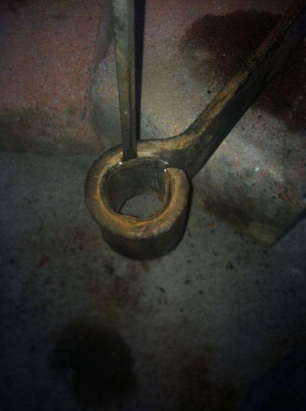

    StAndrew
    StAndrew Wait for it...
    Feb 8, 2010
    #30950
    8,310
    Hampton Roads, Va
    SR5 4x4TRD
    Intake, exhaust, lift. Typical stuff.
    This is not fun... :bananadead:
  4. Apr 22, 2014 at 5:36 AM
    #2344
    MadMtnMikey
    MadMtnMikey Well-Known Member
    Aug 22, 2011
    #62120
    1,480
    Richmond/VaBeach
    03 DC 4x4 SR5 TRD
    Yeah, I did my factory ones this way to add Daystar extended shackles with Poly bushings..... Pain in the butt to say the least.

  16. Apr 28, 2014 at 7:24 PM
    #2356
    IDtrucks
    IDtrucks Unhinged and Fluid
    Jun 2, 2010
    #38254
    23,536
    Mark "Buck"
    Jackson Wyoming
    96' X-Cab 4x4 TRD Off Road Clusterfuck
    JVC Deck, 10" sub mountd in rear seat cubby, 2 LED off road lights mounted in grille, amber raptor style grille lights, LED rock lights, square led bed light, custom made fuse block tray, 12 blade Blue Sea fuse block, 100a marine circuit breaker, black plasti dipped full grille, tinted tail lights + third, Uniden 520 with 4' firestik, Bilstein 5100s with 620lb Eibach coils, Diff drop, Chevy 63 leaf swap, TG creeper joints, 14" triangulated biletein 5125s, 8" extended steel braided brake line, TG Rock Sliders, CBI Moab 1.0 front bumper, custom fabbed bed rack, full TRD E-Locker axle swap and matching re-gear with custom stand alone wiring circuit, 29 spline pinion flange from an 06 wishbone runner, tubbed for 35x12.5" general grabbers on Ultra type 181 wheels, crush sleeve eliminator, Mini ARB compressor, front ARB locker, garage fab aluminum front skid plate, custom built high clearence rear bumper, removable mothafuckin doors
    I found it was WAY easier to to take a drill bit that is as big as the bushing (between the middle and outer sleeve) and drill out the bushing one hole at a time, cut a notch in the outer sleeve, then just pound it out
    adam, did you ever reveal what your big surprise was?

    That's a good method for getting the bushings out if you don't want to smell like nuked rubber for a few days.
    haha i tried to nuke the rubber, because who doesent like lighting shit on fire. But that didnt work so i had to get creative.
