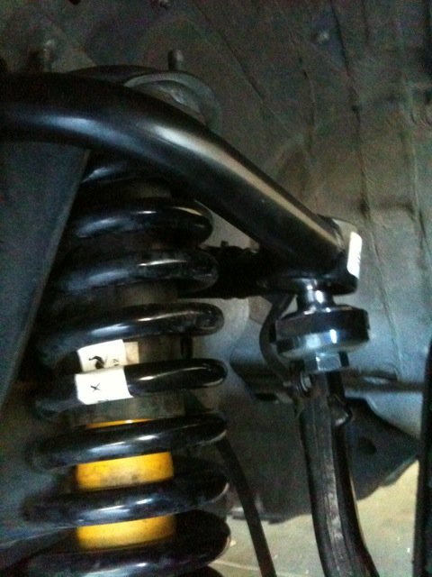

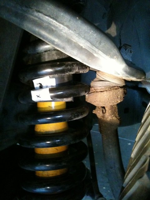

    Here's what I was dealing with with stock UCAs and OME 882s w/ 10mm top plate spacer:
    And the after with the Icons:
    It was interesting. The front end settled down a good bit after installing the Icons. I think it was due to greater range of motion of the uniball coupled with the new bushings. You can see how the top of the spindle sat differently before and after. I'm figuring the lack of range of motion on the balljoint was forcing the UCA to swing in and thus down. Also, the old rubber bushings were quite dry and welded in place. The new poly's are allowing for easier swing when the suspension is activated.
    Apologies, Adam, for posting the pics in your build. They seemed appropriate in light of the conversation. Let me know, I will gladly remove them.

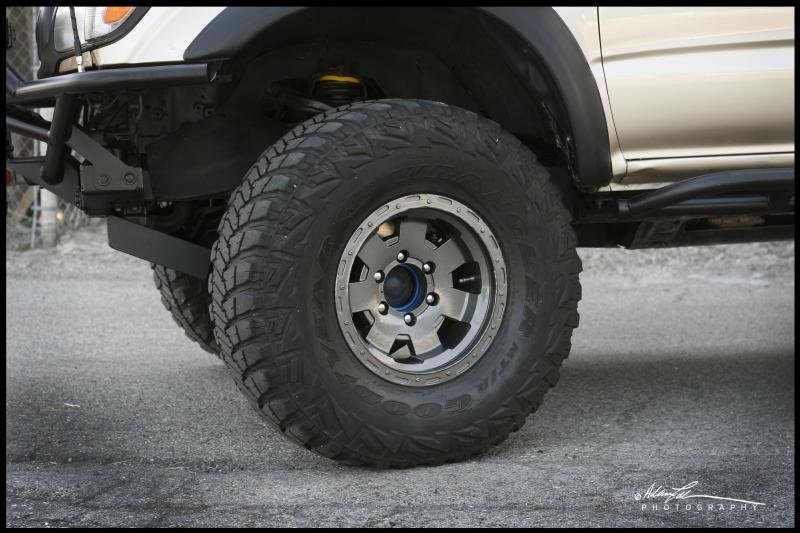

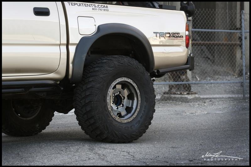

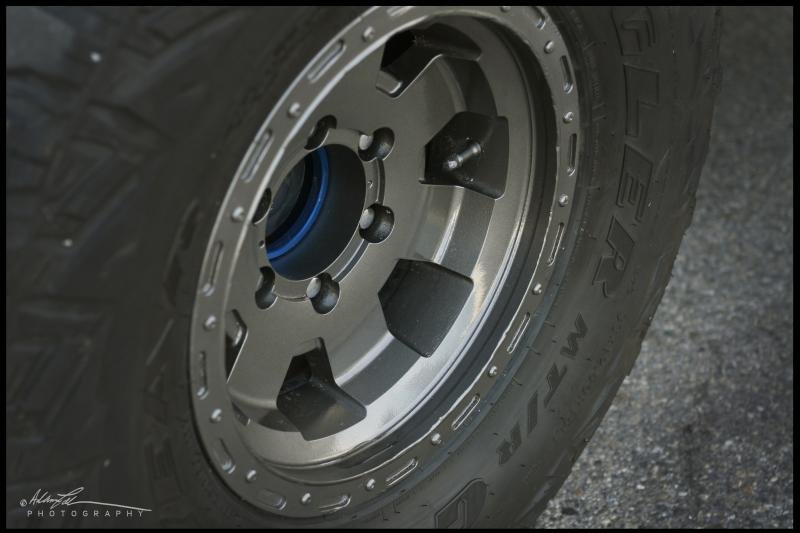

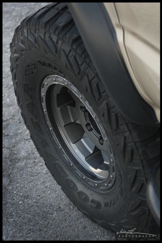

    Refreshed my Ultra wheels again. Spent 2 hours with some Aircraft stripper and removed all paint etc. Cleaned em up and resprayed them with VHT graphite. Thought I'd try the graphite instead of black on them for a change. Still on the fence about how I feel about the graphite on these wheels. I like it on my FZJ80 wheels, but I think I like the black better on these Ultra wheels.
    I'll try to get some pics right away. I'd like some opinions.

    sounds pretty cool.. ive always been a fan of grey wheels because there fairly "rare" everyone has black..

    here's some pics of the painted wheels
