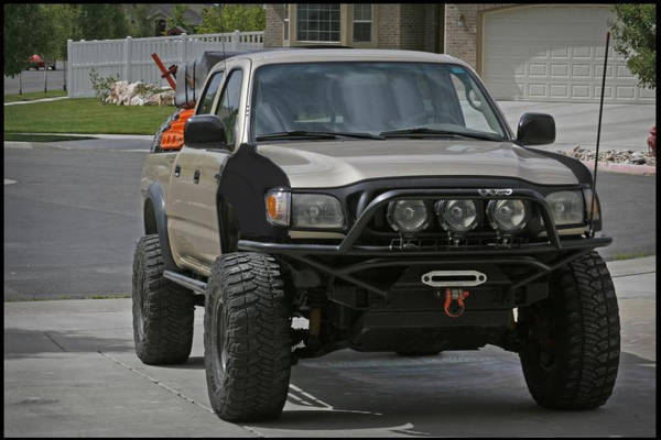

    Yeah I'd just stick with color matched.

    Too many, See Build
    I'm neutral right now, I'm sure once they're color matched it will be sex!

    Color match for sure. I'm not too partial to the glass fenders from a looks perspective, but I understand the benefit. Stoked to see them color matched.

    Glass looks nice. The black fenders look cool but nothing beats color matched, IMO

    Anyone know how much less tire coverage the Bushwhackers give versus glass?

    Agreed mark wheeled like a boss this year..
    i was planning on running the fenders one step up from that and i think im just going to cut the fender bigger to keep my snorkel.

    Yeah, no. Not going that direction.
    At this point I'm thinking no. I still want the benefits of the snorkel though. It has helped a TON with dust on lots of our trips and is cheap insurance for water. I'm looking at routing options for the air intake now without the snorkel, but at this point I think I'm going to leave the snorkel off.

    If you're gonna get the new fenders color matched perhaps consider color matching the back fender flares at the same time....or not, just throwing it out there.
