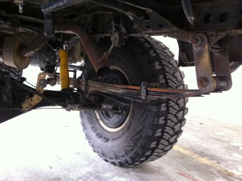

    do your dakar +AAL look flat? even when not loaded?

    Mine are various levels of flat most of the time. They are designed that way :)

    Yes my Dakars are pretty flat. Totally normal and how they are supposed to be. I'd post a pic but I'm away from computers and my photobucket.

    I've heard you could flip the overloads or one of the over load leafs to gain a little lift and maybe gain some arc in the springs.

    They are designed to run flat or almost flat. That's how my Dakar's were

    When mine are loaded they have a slight negative arch...

    Don't do this. They are not designed to be used like that. A flipped overload will not flex and the ride will be more harsh and since it won't flex it will create points of heavy stress where the leaf above it contacts the end of the overload and it could cause the leaves to crack and break at that stress point.
