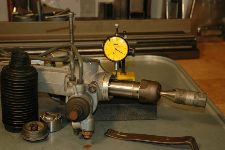

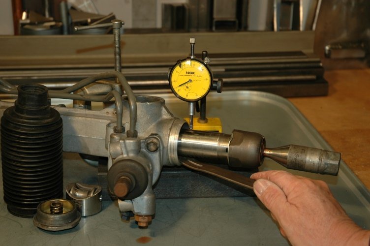

    You see this in the 1st gen section?:

    Yep I've seen that. I'm not seeing that issue with the guides on my rack and the thing I talked about yesterday is totally unrelated. I think it's an EXTREME suggestion to say "DON't BUY AN AAE/SAFARI RACK" . Just because one rack is showing play in the guides prematurely, doesn't mean they all are. And for that matter, reman'd factory racks have been known to have the same issues sometimes and been useless right out of the box. I've even seen a new OEM rack have play in the guides.
    Bottom line is OEM is the best option and best quality. Anything aftermarket is a bit of a crap shoot.
