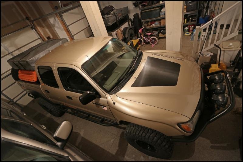

    I had some scrap Carbon Fiber wrap vinyl so I tried this tonight. Keep it or ditch it?

    Looks great on your truck. Keep it.

    Keep. Was thinking about doing that for a bit, but I don't find the glare to be that bad. Sure does look nice though. When you going LT?

    Looks great adam. Keep it

    Looks good, I'd leave it on.

    I have been wanting to play around with some vinyl on a few things. What is your process for big pieces like this? Do you cut the shape and then apply it or is there a way to apply the sheet of vinyl and trim it without ruining the paint?

    Big pieces are kinda difficult. This particular one was extra tricky because I was using scrap pieces. It's actually three different pieces that I had to cut to fit. But it was just a test to see how I liked it. If I decided to keep it I'll have a new single piece cut.
    But I would suggest lots of water. It helps a lot. Get a spray bottle and wet the surface that you're going to apply the vinyl. That will let you slide and reposition the vinyl for a few minutes to get it in the right place and get it all flat which is difficult with a large piece. Use a good squeegee that is designed for sticker application to squeegee the water out.
    I looked at the crawlorado ones. They're nice but too big IMO. that's why I cut my own.
