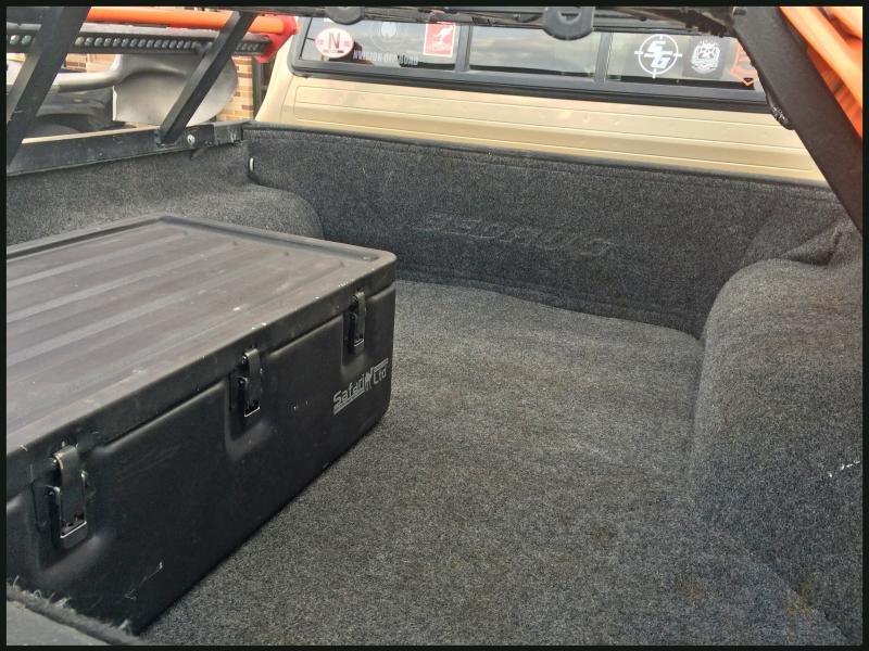

    Picked up a bedrug from a fellow TW'er and put it in last night.

    Nice! How are those things for weather resistance? I typically only see themon trucks with shells or Tonneaus. Are they a marine type carpet?

    how does that work with the snow and stuff? does it soak up?

    From Bedrug's website they are weather resistant. The "carpet" is actually more plastic than regular carpet. It's still very soft, but it won't soak up moisture. The foam backing is also closed cell foam so it is designed not to soak up moisture either.
    Directly from their website: What if the bedrug gets wet?
    "Much like a life vest, BedRug's closed-cell polymer construction can't hold water - it runs right off. The paint in the bed of your truck is designed to shed water the same way the rest of the paint on your vehicle does. The BedRug works in conjunction with your factory drain holes to remove any residual moisture. Unlike spray-in liners which scuff the paint before application and drop-in liners that can scuff and scratch the bed with use, the BedRug's non-abrasive backing will not compromise the integrity of your paint and in turn will not cause your truck bed to rust."

    Nice, I may have to look into one of these. I had no idea.

    dang i always thought you could only use them under a shell.. nice, i bet its really nice on the knees crawling in the bed.

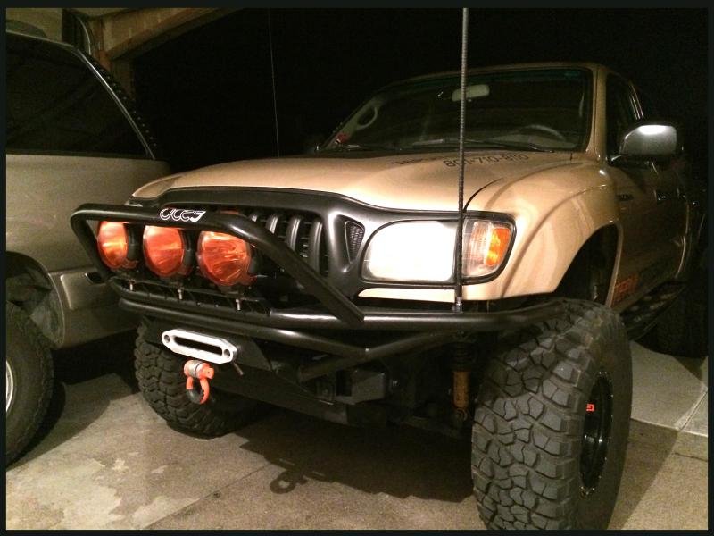

    Trying out some orange filters on my HIDs. I had an old set of clear lens covers that we a little blurry that I replaced a while back. I decided to use them to test out some amber lenses. I used Duplicolor Metal Cast Orange paint to tint them. The Metal Cast paint is typically used to spray over metal surfaces to give it an anodized look. So it's a semi-transparent paint. Worked pretty well on the lenses.
    Now I just need to get some time in the dirt with them and see if it changes anything with light performance in the dust. If it doesn't, no big deal, I still have my clear lenses I can go back to.

    Looks dope too

    I have heard the amber really helps in snow and fog as well. I have a amber lens for my light bar I am going to swap in at some point to try as well. I will be interested to hear your experience.

    I have a bedrug in my tundra. Zero complaints and nothing but good things to say about it. Rain, snow, mud, whatever. It doesn't matter. Just pressure wash it later. Looks as good as the day I got it too.
    It's made completely out of polypropylene, no fabric at all so no mildew. Hell I spilt almost a gallon of bleach in mine and you can't tell at all.
