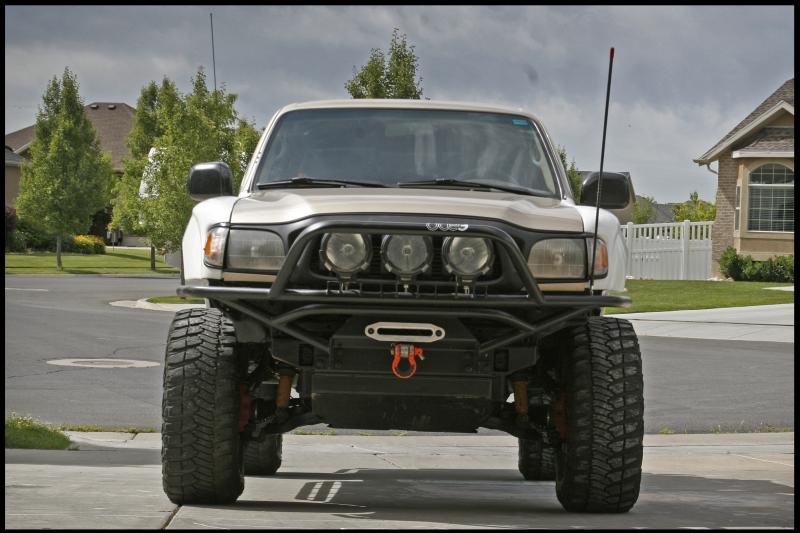

    Adam, do u have a pic of your cv angels?

    This is the best I've got of the CV's
    Sconce93, you've been given some good advice on your Kings. But to answer your question about my setup. For what I do, I like the OME suspension a lot.
