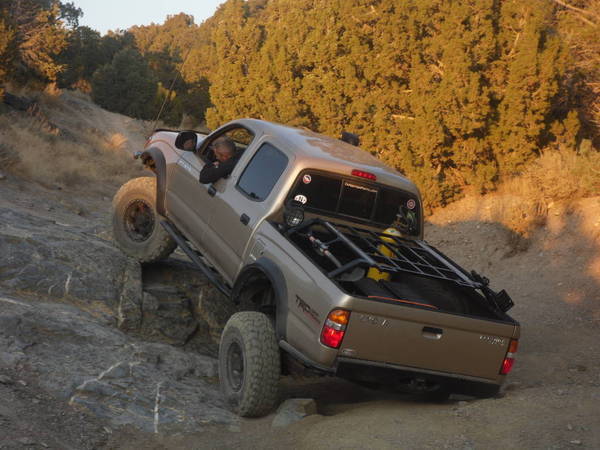

    Thank you. The truck still needs a few things but it's been a good one.

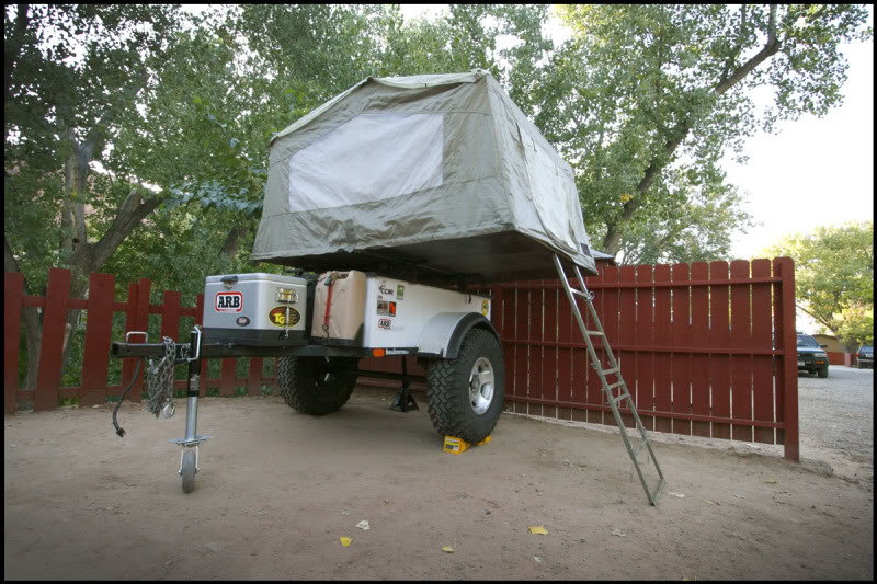

    Trokita took this one last night on our quick run out to Rattlesnake. Thanks Arturo!

    I've been looking for a trailer that size and shape since I saw yours. :) Sweet truck dude. Always like checking out your pics. The Golden Crack?? I knew a girl in college named....oh, nevermind.

    box rocket...your truck is absolutely beautiful...by far my favorite on TW. When I start building my truck to be a expedition/adventure style truck yours will be the inspiration.
    After seeing the TG low-pro bumper on your rig, I am positive thats the bumper I will be going with...have you put it up to any abuse to test out how good it will hold up?
    And I see you run the stock skids...any problems there?

    The TG bumper is holding up fine.
    The stock skids are taking some abuse and it shows. I need to pull the main skid off and pound out a few dents until I can get a real skidplate. Either a Budbuilt or a Skidrow, haven't decided

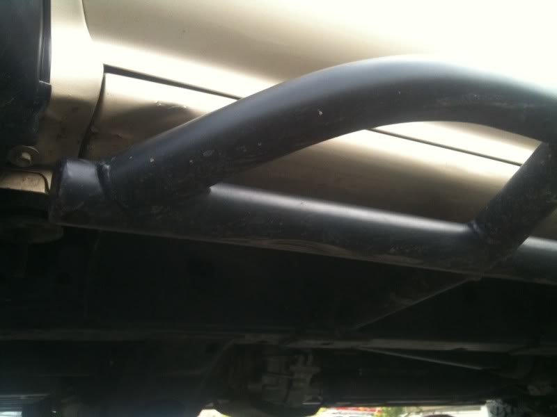

    Just noticed this a couple days ago. If any of you are familiar with the Golden Spike trail in Moab, Utah you know that there are countless ledges to climb and drop off of on that trail. There was one ledge that I dropped off of that bit me. I came down HARD, and I mean HARD on my driver side slider. I got out to check everything and the slider was scratched and had just the slightest dent. It wasn't until I got home and was doing a more thorough check of stuff on the truck that i noticed the small dent in my rocket panel. My sliders have a little bit of clearance under the rockers but are pretty tight to the body. I've come down on them hard before but they've never flexed into the body. Just more evidence of how hard I hit this time. Oh well, you pay to play.
    In hindsight I could have avoided this with better placement of the legs on the sliders. When I welded the sliders together I lined up the legs with the spreaders in the slider body. That left about 12" of slider forward of the leg. With as hard as I hit there was surely a lot of leverage on that forward portion of the slider. If I had put the front and back legs closer to the ends of the slider I don't think this would have happened.

    How far are the legs spaced in between eachother?

    I have the legs lined up with the spreaders in the slider.
