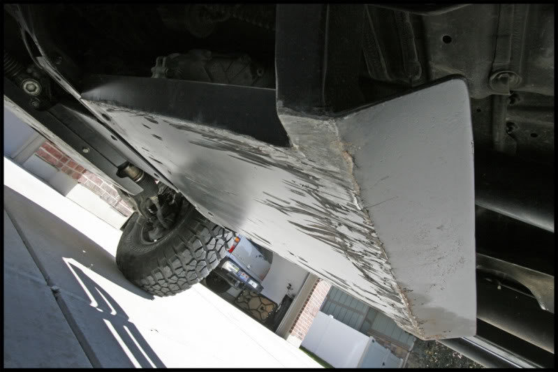

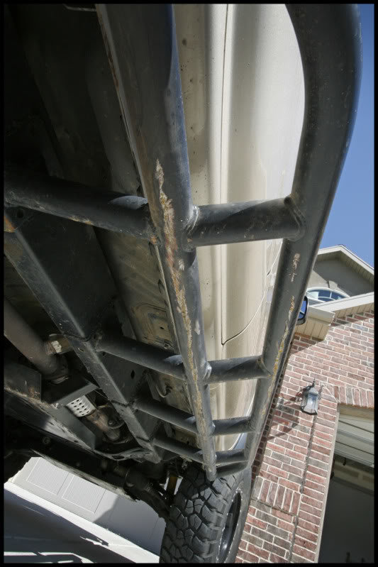

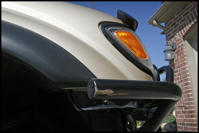

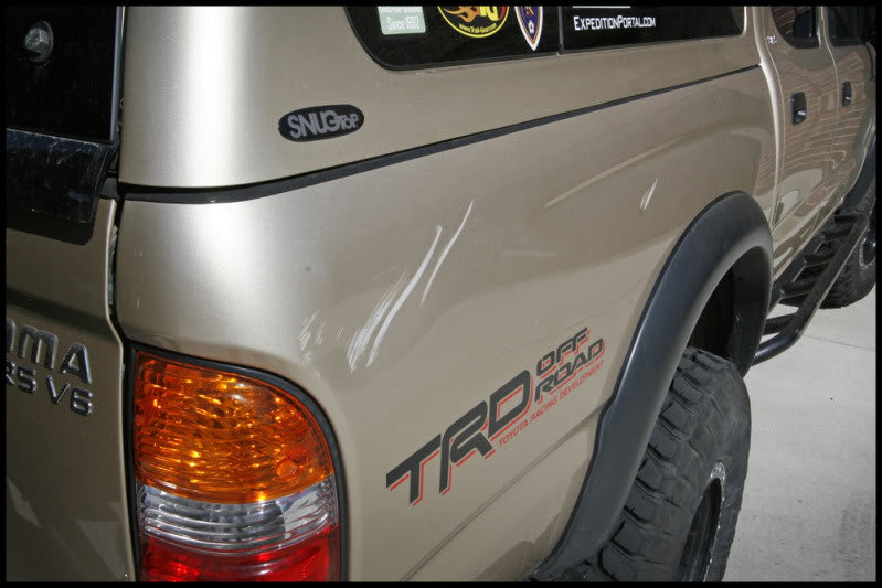

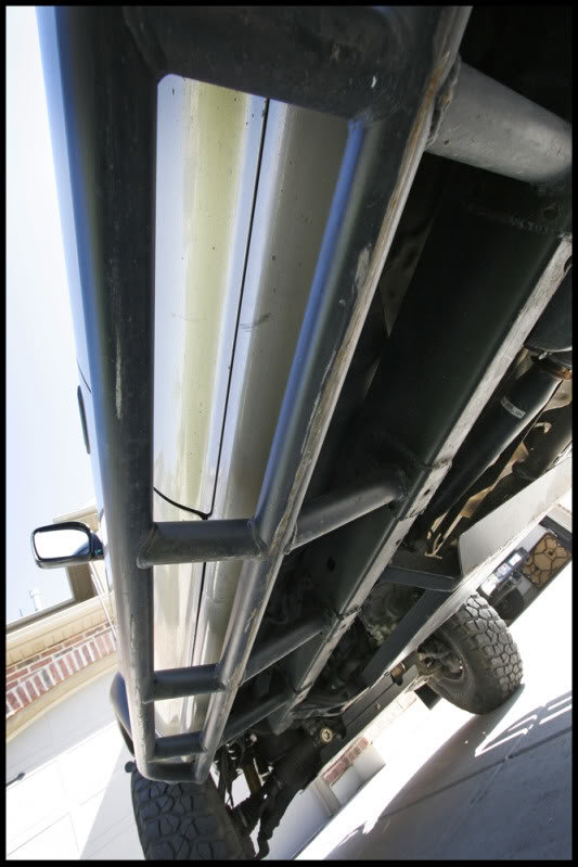

    Question on the feet and gussets. Did the kit come with them or did you order them seperate?
  10. Sep 10, 2016 at 8:22 PM
    #3350
    Cadmus
    Cadmus Un-Known Member
    Jul 25, 2015
    #160299
    426
    Fort Collins CO USA
    '04 4door 4x4 TDRoffroad

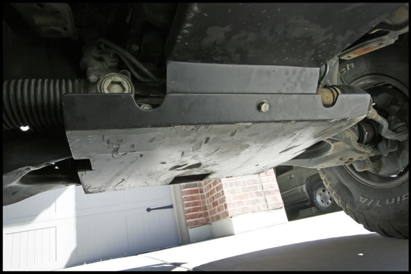

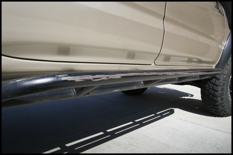

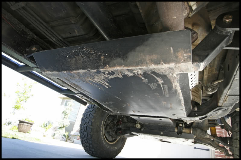

    This might be the most informative series of photos i have seen on this topic. The paint scratches from one single trip on an immaculate well armored truck. This helped me redesign how i will make and locate armor and where i will locate racks and hitches. Great photos here and throughout your thread.
    (I am planning to post more responses as i re-re-re-read this thread. great job on this truck)

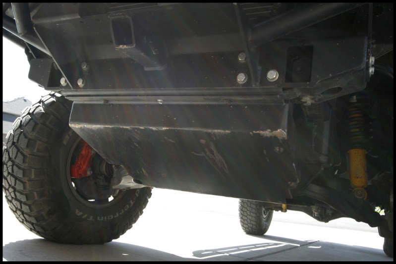

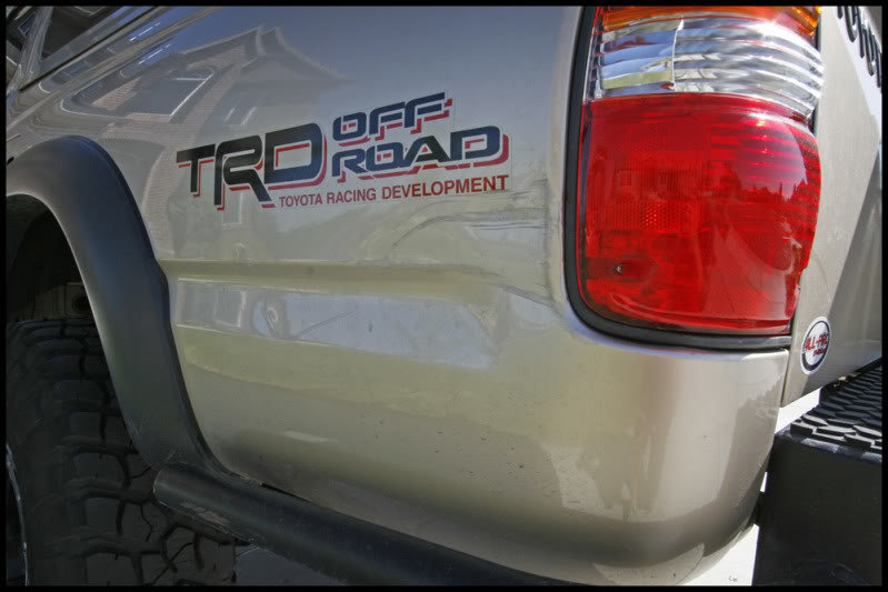

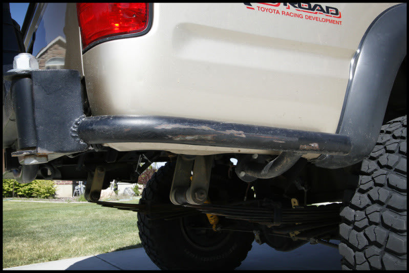

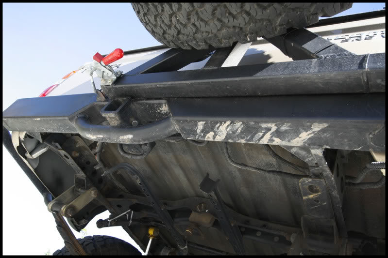

    Hey, I know you sold the truck but Im about to start building my rear bumper and I was wondering if you ever had any problems having the 3x5 so close to the bed? Looks like its less than 1/4" in your pics, wondering if it might hit if the body flexes enough
  13. Feb 6, 2017 at 12:40 PM
    #3353
    Blackdawg
    Blackdawg Dr. Frankenstein
    Dec 31, 2010
    #48500
    81,631
    Monte
    Wyoming/St. Louis
    The Trifecta of Taco's
    The bed is solid mounted to the frame. No bushings so flex is minimal.
    Lux[QUOTED] likes this.
  14. Feb 6, 2017 at 12:46 PM
    #3354
    Lux
    Lux @jamesgrouss
    Sep 15, 2014
    #138357
    2,880
    James
    NJ
    2001 tacoma sr5 4x4
    OME 3" lift 881 coils, Dakar's 33" General Grabber AT2's TG low profile front bumper
    alright sounds good, so I guess 1/8-1/4" on either side should be fine
  15. Feb 6, 2017 at 1:28 PM
    #3355
    Box Rocket
    Box Rocket [OP] Well-Known Member
    Mar 1, 2010
    #32389
    7,184
    Adam
    Syracuse, Utah
    1995 FZJ80 Land Cruiser
    3xLocked, lifted, well used
    Never had a problem with it.
    I purposely built it to be tight. The bumper worked fine but my sliders were tight enough that they would contact the pinch weld on a hard hit. I put a 1" body lift on the truck and never had any issues after that.
    Fuergrissa and Lux like this.
  16. Feb 6, 2017 at 2:14 PM
    #3356
    Blackdawg
    Dec 31, 2010
    #48500
    81,631
    Monte
    Wyoming/St. Louis
    Best way is to open the tail gate and check clearances there. 1/4'' below that will be great or 3/16''
