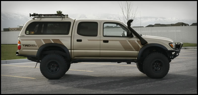

    I'm digging it! I've been toying around with vintage stripes, but never could get them to look quite right. Love these though!

    I'm always amazed with what you think to do to your truck next. I like what youre thinking about the decals, it looks sweet :D

    I think you have the best looking 1st gen on here. Great work

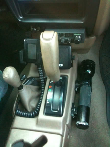

    Not much to report, but I swapped out one of the lift struts on my Snugtop the other day and mounted my maglite in the cab.
    phone photo. :rolleyes:

    What # are the struts on your shell? Mine were both shot when I bought the truck. Replaced them but the lightest weight I could find was 40# :eek: Way too hard to open/close.

    As for the photoshop of the old school decals... looks cool, I admit, but IMO your truck is too clean looking and the decals end up being distracting.
    That's just my eye, of course.

    I'll look at them again. I found some replacements at a local warehouse. They aren't exact replacements but worked. They were pretty light.

    Thanks. The only ones I could find in the right length were the 40 pounders. It takes both hands to open/close the door now. I don't let anyone else open it because I'm afraid they will get an uppercut on the chin from letting it "spring up" on its own.

    I like the decals...i gotta photoshop some of those on a lunar mist truck....

    Those graphics are sick! Id do it dude
