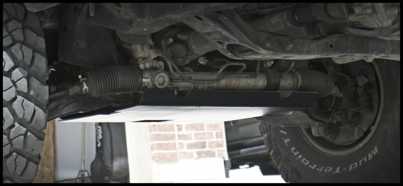

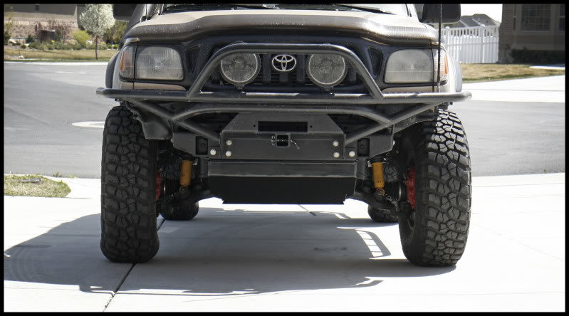

    Built my new front skidplate last night and finished it up this morning. Turned out pretty good. Next up is the trans and belly skid this next week.

    looks good! nice work.
  7. Apr 7, 2012 at 2:25 PM
    #527
    TacoMX
    TacoMX TW's Official anti body-lift pundit
    Aug 24, 2011
    #62240
    4,825
    Jonathan
    Deltona, Florida
    Very nice!! I like the way it wraps around the rear of the R&P...nice work!!

    Very nice that is similar to how I have been thinking of making mine

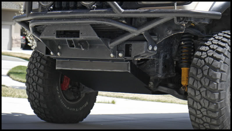

    Take a look at the Budbuilt skids. Mine will be similar. The tranny skid will bolt to the angled part of the front skid and to the t-case crossmember. The belly skid will also bolt to the t-case crossmember and to a custom crossmember farther back.

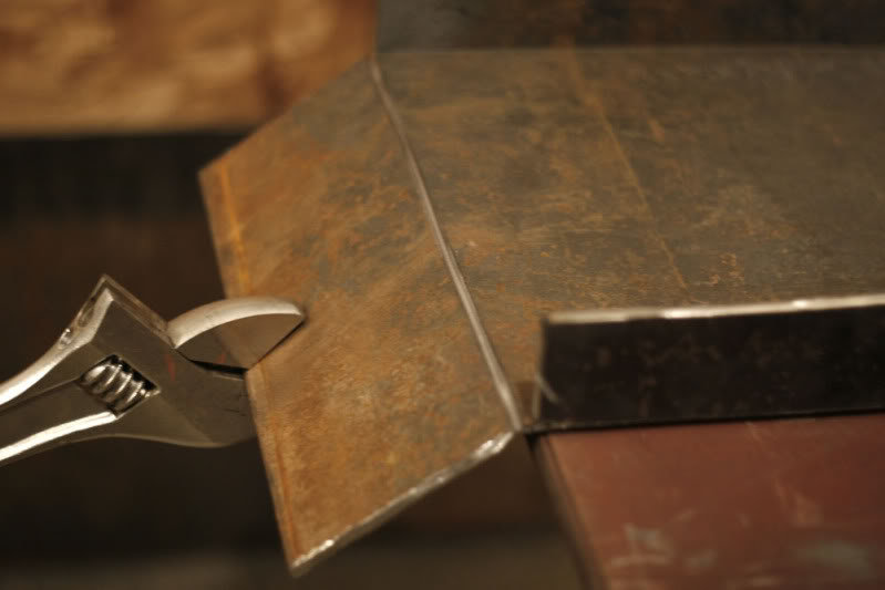

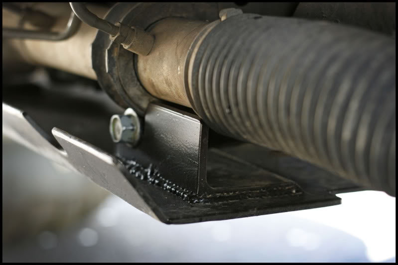

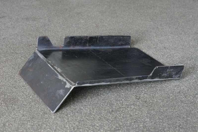

    Built the trans skid last night and used the same 'whiskey bend' method as I did on the front skid. I had several people ask about how I did that so here are a few pics.
    using a cutting wheel I cut almost all the way through the plate ( on the outside of the bend) and bent the plate. The gap is then fully welded and ground smooth.

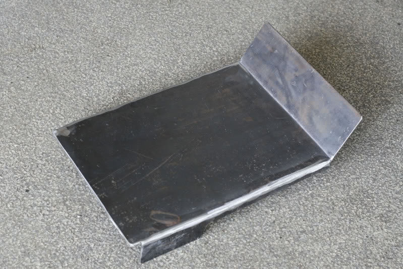

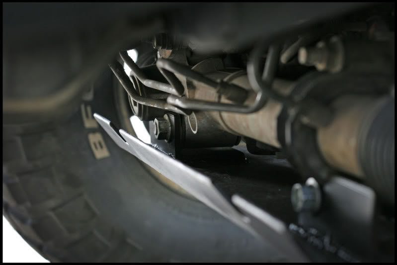

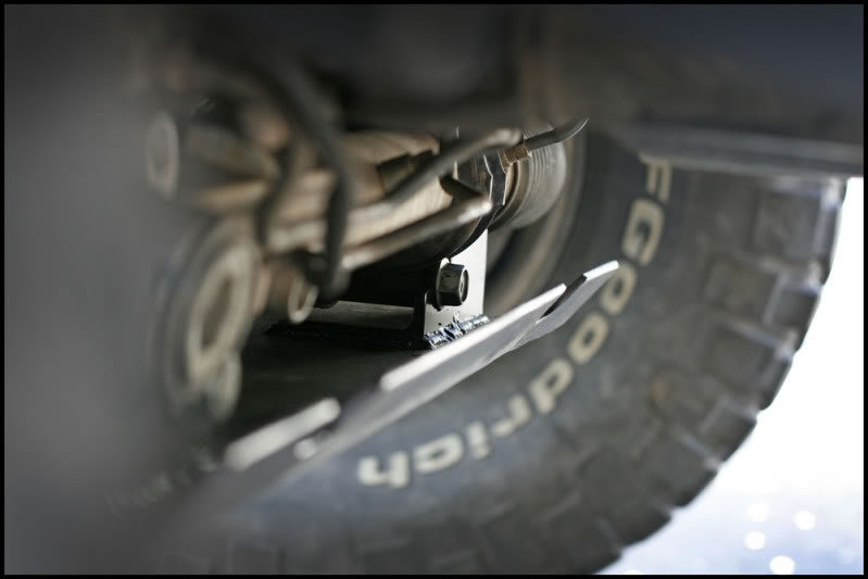

    Couple pics of the trans skid. Like I said, it still needs paint and a couple holes drilled so I can bolt it to the back of my IFS skid (the slanted peice will attach to the front skid) and there are a couple custom brackets welded to my stock crossmember where it will attach on the back.
    It covers just the tranny pan. The upright peices are notched to clear the tube going into the pan on the passenger side, and the driverside is clearanced a bit more for the driveshaft. I could have made the skid wider but I chose not to in an effort to keep the weight down as much as I could. It still covers what I need it too.

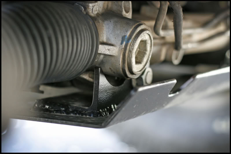

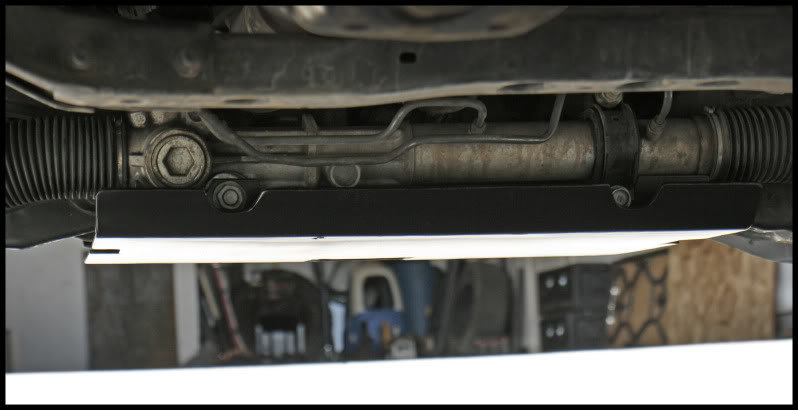

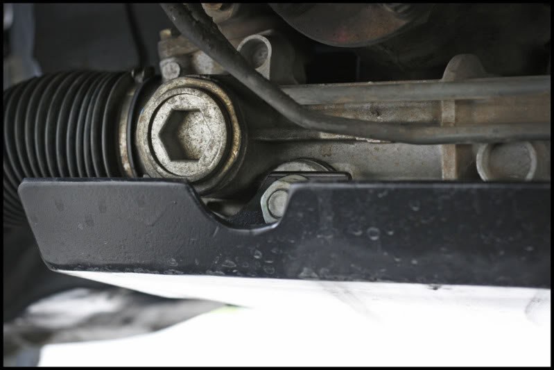

    Lastly, some had asked to see better pics of the brackets on the rear of the front skid where it attaches to the steering rack. I had to custom shape these to fit around the steering rack but they're solid and should work well.
