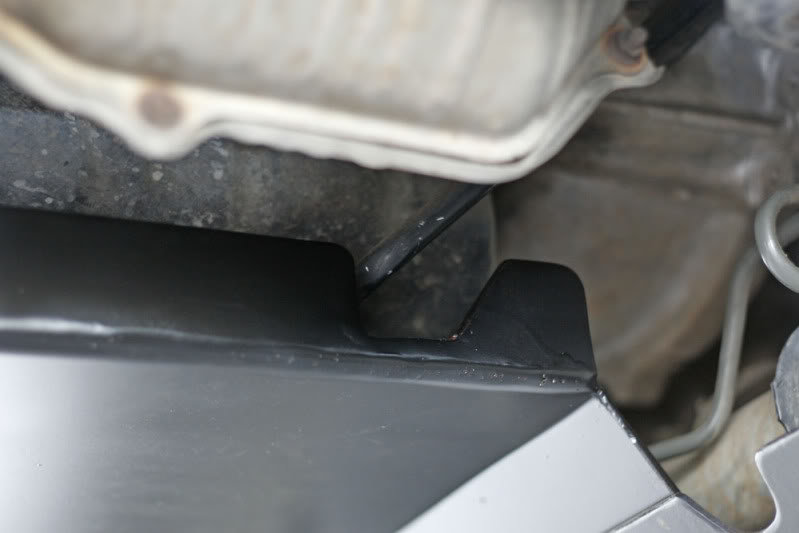

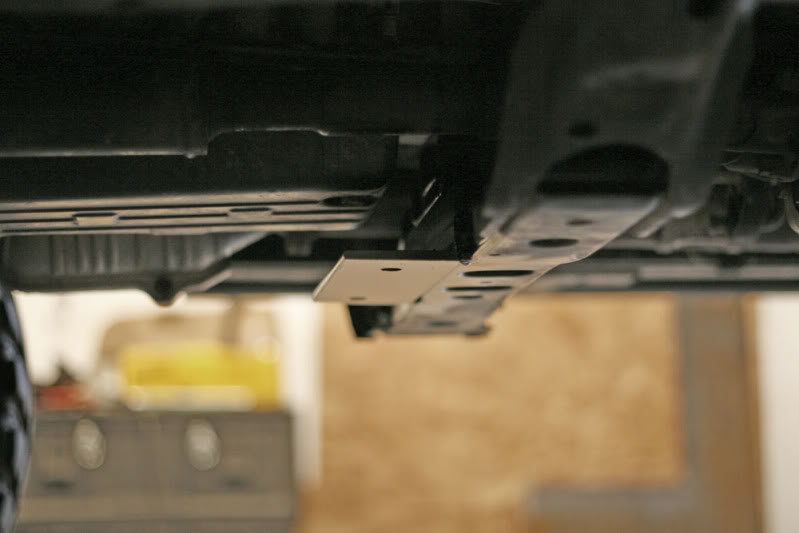

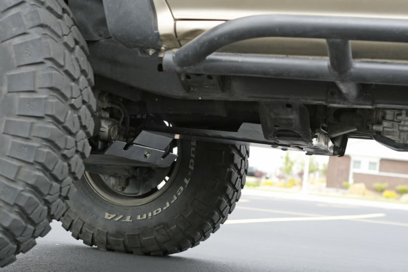

    finished up the transmission skid last night. My guess is that it won't take too many hits so it's attached to the IFS skid with a single bolt for now. I'll add more front attachment later if needed.
    At the back I welded a heavy angle bracket to the factory crossmember that the skid bolts to. The belly skid will attach the same way to the back of the crossmember so nothing will be lower than the factory crossmember. Used a couple carriage bolts so they'll slide over the rocks better than regular bolts.
    Here's the bracket welded to the crossmember
    from this side you can see how the side is clearanced for the driveshaft.
    On the passenger side you can see how the side is notched for the trans fill tube.

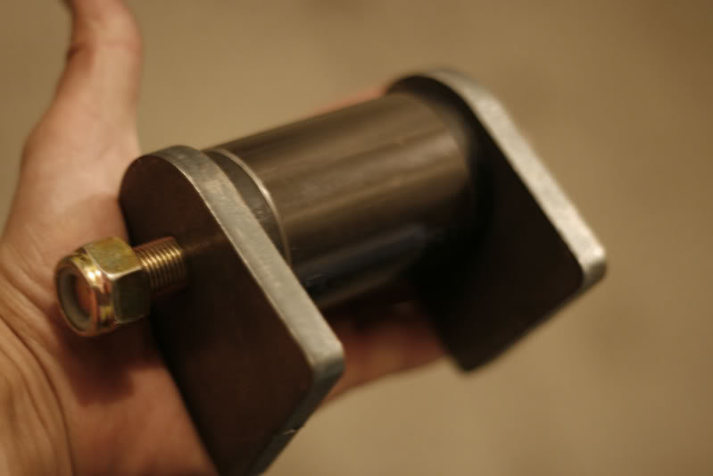

    I got started building the belly skid last night. I'm using one of the super beefy brackets from Ruffstuff for the rear belly skid crossmember. A pair of these will be welded to the frame behind the tcase. Another heavy angle bracket will be welded to the back side of the factory crossmember for the front attachment of the belly skid. Nothing will cover the holes in the factory crossmember so that I can get to the tranny mount bolts easily if I need to.
