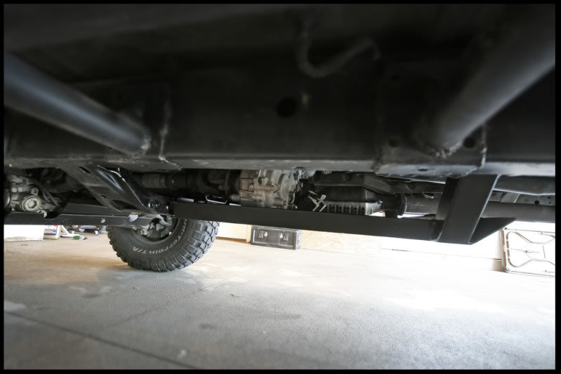

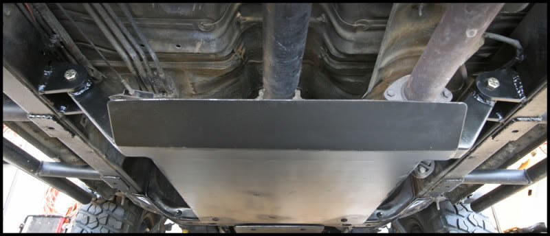

    Skids are all done. Finished up the belly skid today. Pleased with how it turned out. Pretty beefy 2" crossmember at the back mounted to the frame with the Ruffstuff brackets. 3/16" plate, with a couple reinforcement ribs in the middle. Sides are at about a 60* angle instead of 90* to help protect the cat a little better and hopefully help to slide off rocks a bit better.
    There is about 1/2" of clearance under the tcase. Should be enough room to not make contact but about as high and tight as I dared. Nothing is lower than the factory crossmember. Stoked to have fully protection now with the exception of the gas tank.

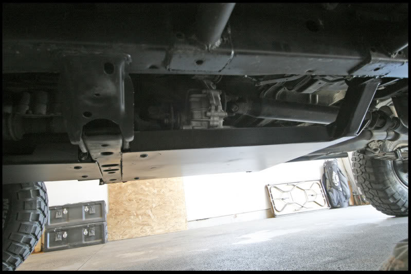

    From the side you can see that it's all flush with the factory crossmember with carriage bolts on the tranny and tcase skid to slide over rocks better.
    From the rear. Angled the rear of the skid up to help slide in reverse rather than get hung up on the new crossmember. You can see the Ruffstuff brackets on the frame in this shot. They are beefy!

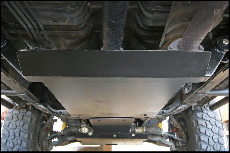

    Shot of the full skids from the back.
