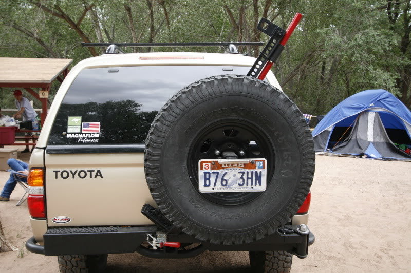

    Nothing big but I fabbed up a hilift mount on my tire carrier. There are a few times when I don't have the topper or my bed rack on the truck (the other two places where I mount my hilift) and this allows it to be a more permanent fixture without having to move it from the rack to the top or vice versa.
    Not a great pic but the only one I got while in Moab last week. The wide angle lens make it look like it sticks out a lot more than it does. It sticks up past the corner of the top but only by a little bit.

    Mind getting a shot of your high lift mount with the tire off?? My tire gate bumper will be here soon and id like to do that to it i think.

    Yeah i'll try to get a picture. Mine is super simple with a base plate and one upper bolt to hold the top.

    License plate wiring is tied into the tail lights and comes through the center of the spare tire. I have a receiver tube in the center that the license plate bracket slides into and the wiring comes through the center of the tube.
