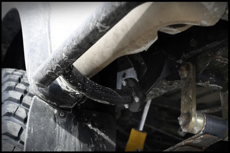

    Today was my last day off work for the holidays and I had a little time today so I finally got around to finishing up my rear bumper by adding in the brackets to tie the sliders back into the frame.
    I used a pair of Trail-Gear 4Runner rear bumper brackets, and they worked out perfectly with my home built bumper. I'll get pics soon when its not so crappy outside. BTW, I HATE welding upside down.
    K bai.

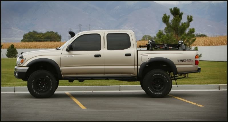

    couple updates.

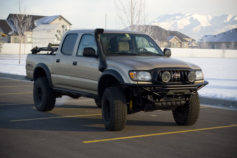

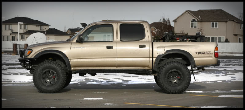

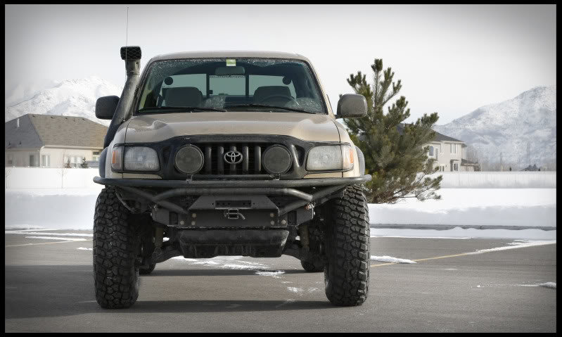

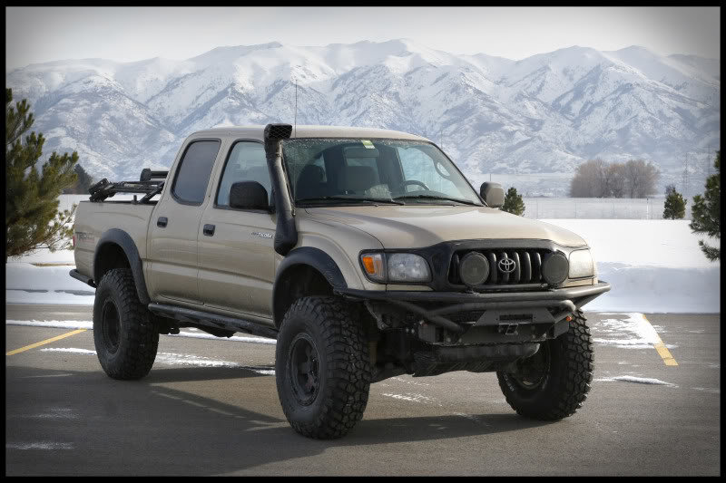

    I have needed to finish up my rear bumper by adding some bracket to the rear corner protection and tie it back into the frame. I found some nifty little brackets from Trail-Gear that are meant to work with their 1st Gen 4Runner bumpers. I hoped that the tube work I did was close enough to the same location that I could use these same brackets. Turned out that they worked perfectly. Nice to add a little bit of extra strength the rear bumper.
    Forgive all the winter salt and crud all over the truck. Weather has been crappy here.

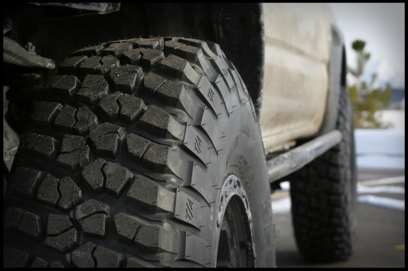

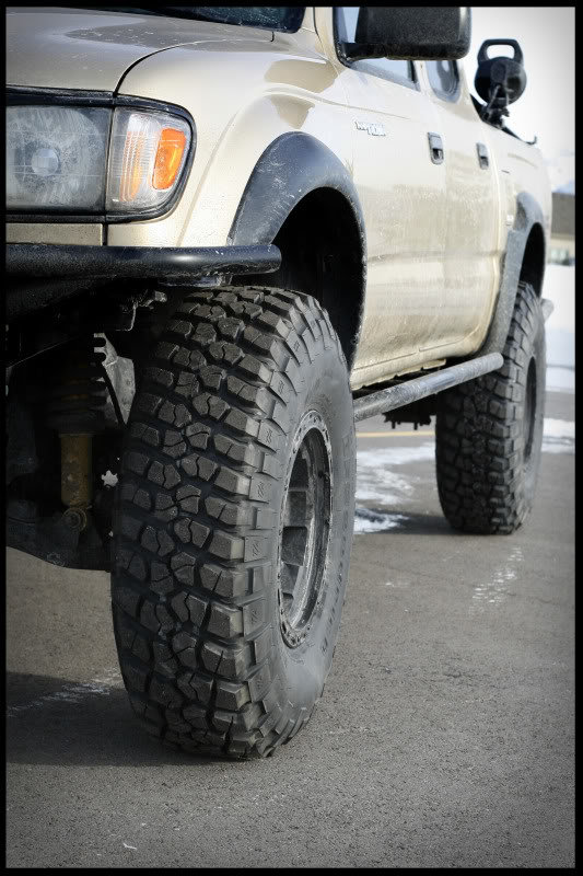

    Also....the 32x11.50 BFG ATs that were on the truck when I bought it still have some tread left, but weren't wearing well after the previous owner overlooked an alignment. Also the rubber had started to get hard and they were pretty slick in the snow. So this morning I got a new set of tires. Trying out some skinnies for the first time. We'll see how it goes. Went with some 33x10.50 BFG KM2's. Got them at Discount tire for a pretty good price...~$150/tire after I found them at onlinetires.com for $131 before shippping. Discount price matched the price after shipping. Also had them siped, so we'll see how they do for the rest of the winter.
    I like how they look. They are just a bit more noisy than the ATs but that is to be expected. They should fit ok in the front but I'll probably need to trim a little of the rear flares to get rid of all the rubbing.
    Pics.
    Before: 32x11.50
    After: 33x10.50
    Before: 32x11.50
    After: 33x10.50
    From the front.

    Did you take your tint off? How much rubbing did you end up with? and what kind of backspacing are those rims?
  15. Jan 11, 2011 at 5:37 PM
    #75
    Box Rocket
    Box Rocket [OP] Well-Known Member
    Mar 1, 2010
    #32389
    7,184
    Adam
    Syracuse, Utah
    1995 FZJ80 Land Cruiser
    3xLocked, lifted, well used
    Yeah, removed the tint from the front windows. It was too dark.
    Not much rubbing yet. A little bit at the front of the rear wheel well, but it shouldn't take much trimming. I'll also need to flatten the pinch weld in the front a little more than it currently is.
    No idea on backspacing. The wheels were on the truck when I got it. If I had to guess, they are either 3.75" or 4" BS.

    #26720
    2,426
    04 4x4
    :drool:
    Amazing! That one size make a huge difference! Looks awesome!
