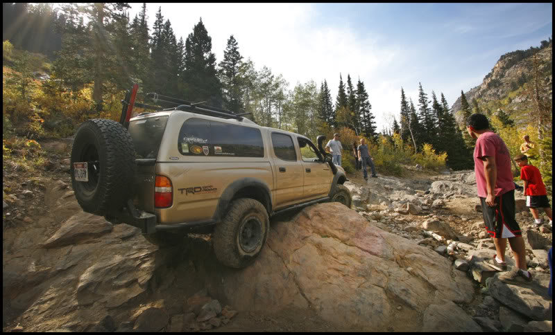

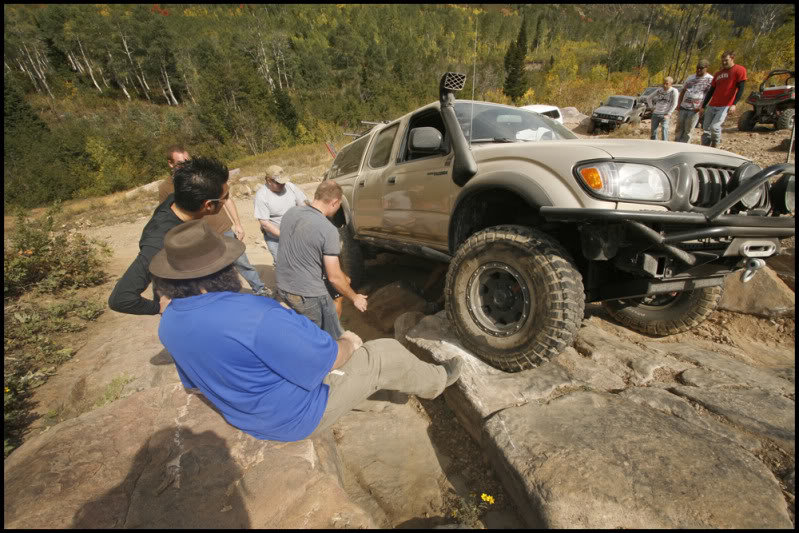

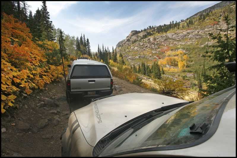

    good weekend

    where did you go? looks like fun! i need to get out wheeling....

    American Fork Canyon, Mineral Basin Trail. Near Alpine, Utah.

    very nice...mountains look sick up there...
    i see you are having some changing colors finally over there
