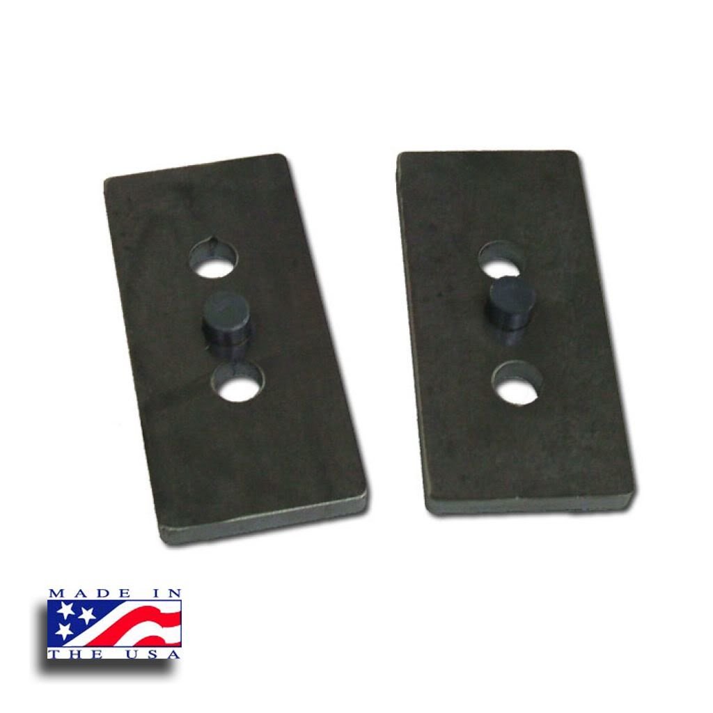

    Are you talking about something like these 80_1234156912_9eb2deddf1002fe473040e42f4987a1b2c899080.jpg
    I installed plates like those on my truck to center the axle the wheel wells. It seems like the OME leaf packs change the position of the axle in the wheel wells.
  16. Feb 13, 2013 at 2:23 PM
    #1036
    Box Rocket
    Box Rocket [OP] Well-Known Member
    Mar 1, 2010
    #32389
    7,184
    Adam
    Syracuse, Utah
    1995 FZJ80 Land Cruiser
    3xLocked, lifted, well used
    Yep, that's what I'm talking about.
