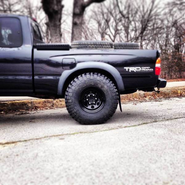

    my reloaction plate is on order.... i think im just gonna go 3/4 " back first and see what that gets me

    Wow, your axle is too far forward?

    Mine is too. I need to move back about 1"

    yeah ive been reading ome dakars and another pack(i forget) both locate the axle n inch or so more forward. im gonna start with 3/4 tho and see what happens. Your not worried about slip yoke length are you Adam?

    Oh, gotcha. With my add-a-leaf and tires it moved mine back. I'm not usre how much, I haven't measured yet...

    The slip yoke is in the back of my mind but I just won't know if it's an issue until I try. I know there are a lot of people using the axle plates so I know it can work just fine. I just need to try both settings and see which one works best.
