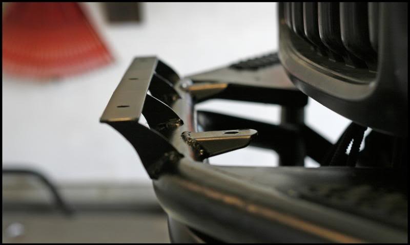

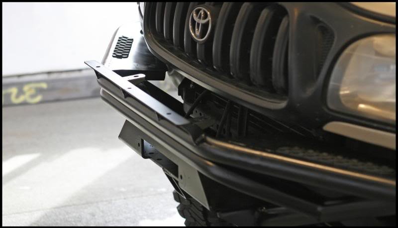

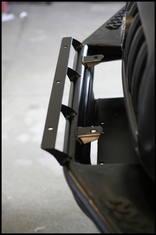

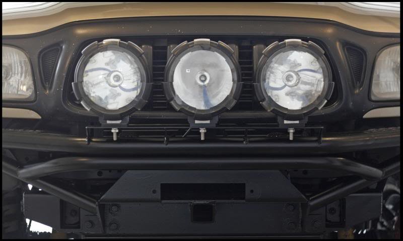

    Had some time last night so I worked on my front bumper and new HID's I picked up from a fellow TW member.
    In order for the new lights to fit I needed to remove the lightbar from my TG bumper. No pics of the process but I cut it of. The light tabs that I was using for my Black Magic lights were on the backside of the bumper but the internal ballasts on the new HIDs were in the way if I used lighttabs on the backside of the bumper. So I needed to make some new tabs. I didn't want the lights to stick out too far so I didn't want the new tabs straight off the front of the bumper. I also wanted the lights to sit just a bit higher than the bumper so that they centered in the grill better.
    So I fabbed up a little lightbar that I welded to the top of the bumper. The 4 little curved uprights were the only part that really took any time since I had to cut them with my angle grinder. I shaped them with a flap disc. I left the old tabs on just in case.
    After that it was pretty straight forward. Wired them up and took some pics. Excited to have better lighting up front now.

    What brand lights are those? I plan to go with 2-3 HID's up front eventually.

    Hella Optilux 7" HID
