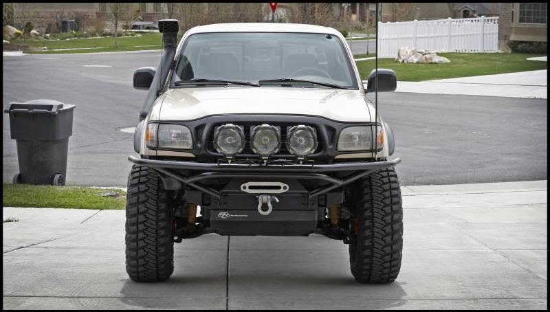

    fender stripes came off last night. It was a huge mod. ;)

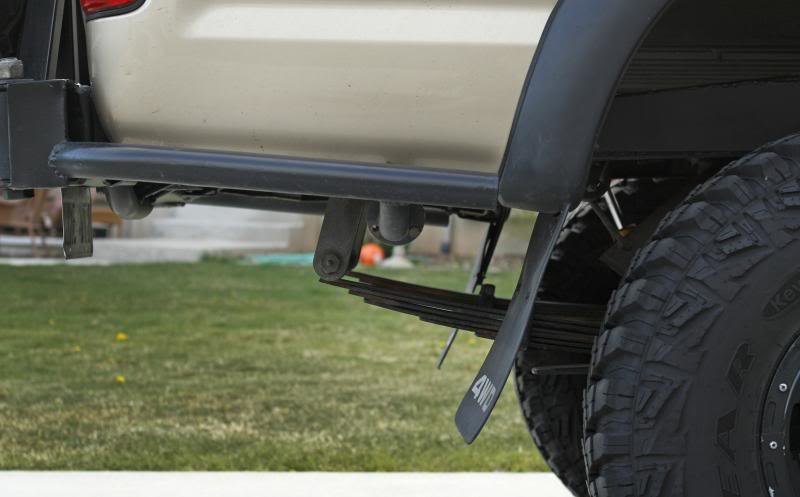

    Installed my 1.5 shackles and had a question for you. Mine are almost vertical like yours. At full droop I'm worried that the shackle may collapse forward. Is that something to worry about?

    I have never had an issue with my shackles inverting. Mine are not quite vertical. Your new ones look a bit more vertical than mine but you've also got brand new springs. I would get some weight in your bed and go flex them out on a trail or two. Once those springs are broken in, I think you'll have a better shackle angle.
    I snapped this photo tonight of my shackles. This has the weight of the rearbumper and tire carrier, but no topper or bedrack.

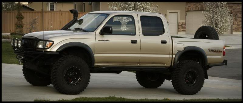

    And while I was outside I snapped a photo of the truck. Notice no fender stripes anymore. :) Was getting to many copycats. ;)

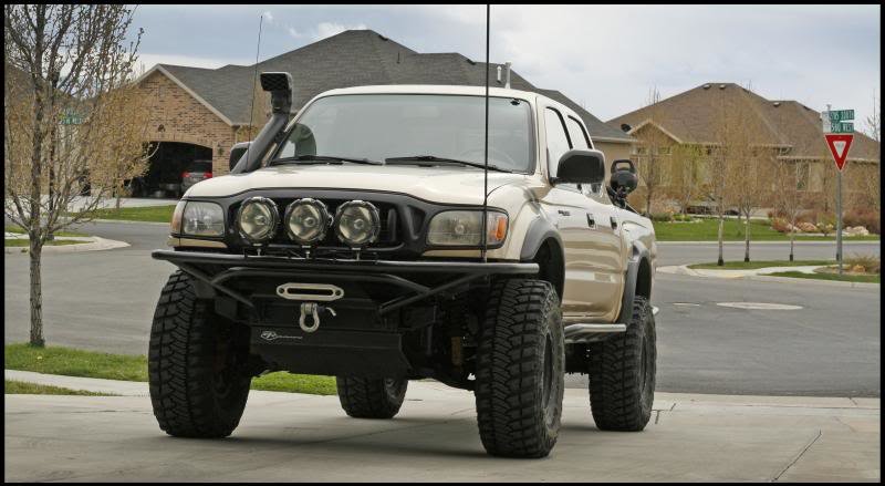

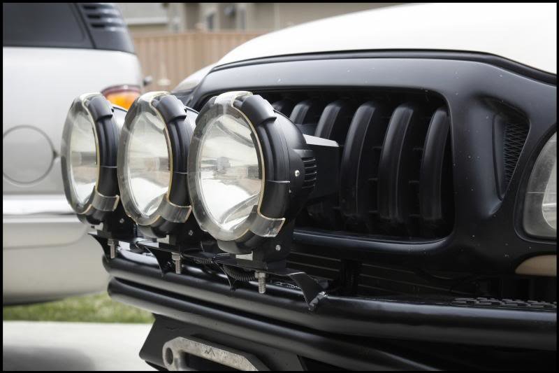

    Yeah.... I agree. it's mostly the lift shackles fault though. The shackle angle would be happier with the stock shackles...

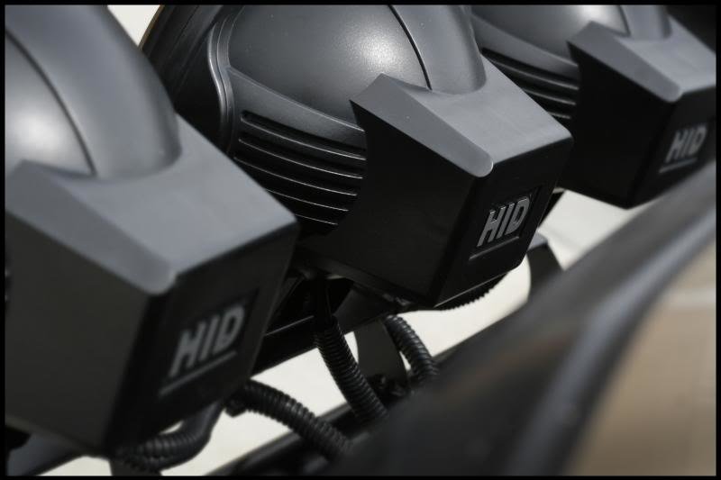

    PS the lights look AWESEOME, Adam!I wanted to go with 3 on mine.. :eek: and get a yellow dustcover for the centerone

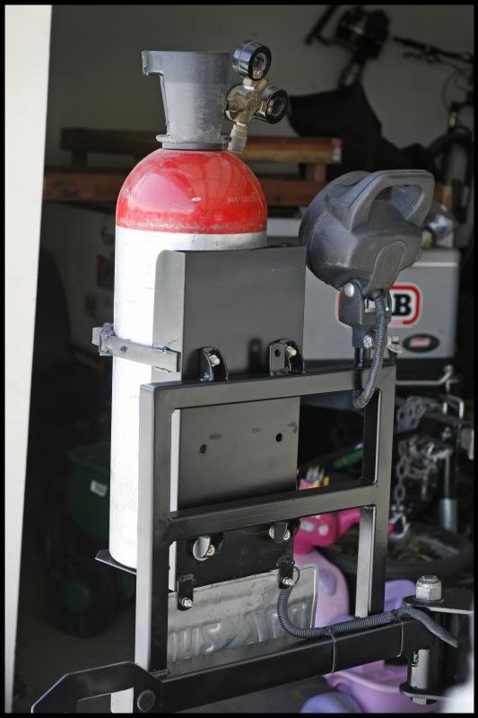

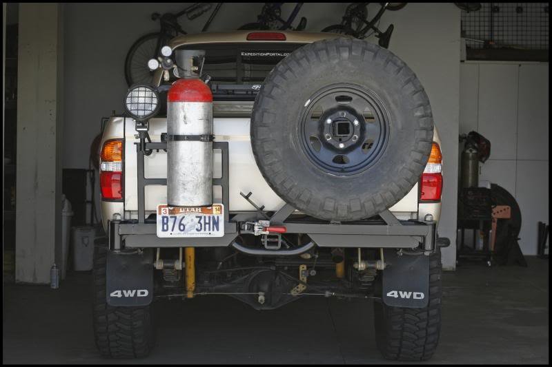

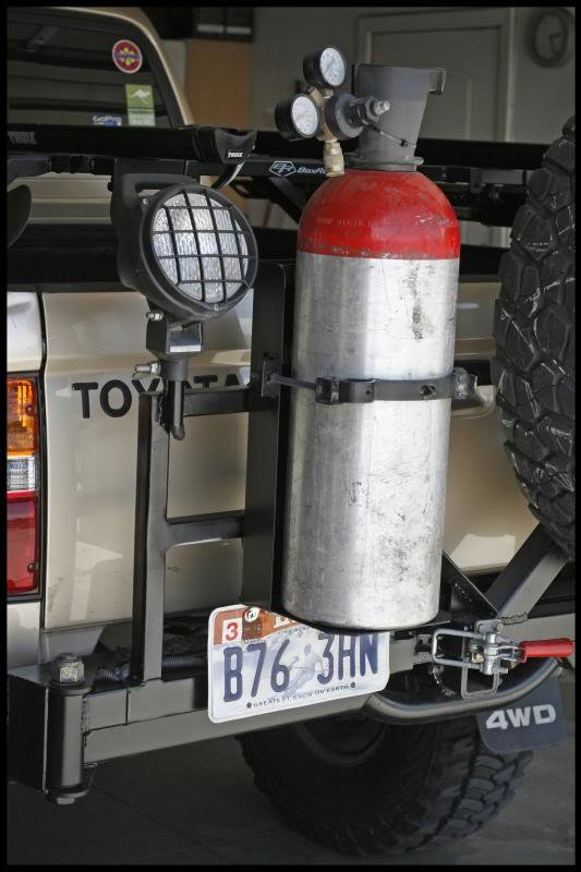

    Made a small change yesterday to my second swingout. I've been using it to carry extra fuel/water. But it's not that common that I need to have extra fuel etc with me unless I'm on one of our longer trips, and I've usually got my trailer with me on those trips and I carry the fuel/water on the trailer.
    It's way more common that I need a source of air. I've never been totally happy with how I've carried my CO2 tank so I changed it up. I cut the fuel can basket off the second swingout and attached the bracket for my CO2 tank. Added a new mount for my ulitity light to the swingout.
    Small change but I like it.

    Nice.
    Not sure I'd like having my tank back there..but looks cool
