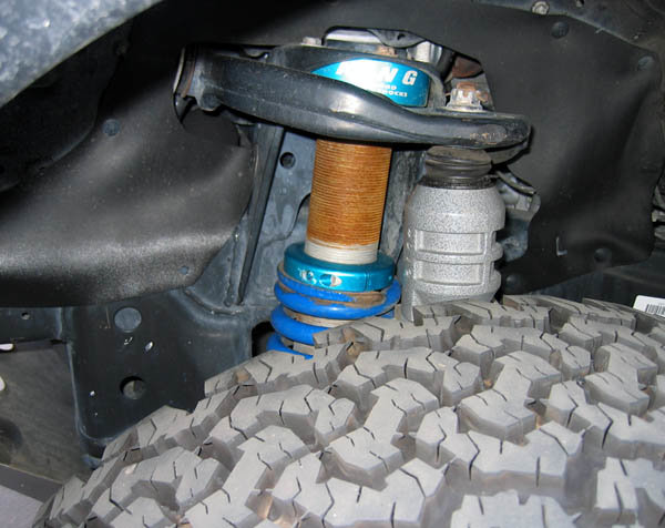

    Here's one example. The threaded sections/collars get trashed in the winters here in Utah if you spne time commuting on the salted highways. It can really do a number on the powdercoat on the coils as well. Uniballs used in aftermarket upper control arms can take a beating as well.
    None of this means they aren't great products. It just means you need to be aware of the potential wear in this climate and plan accordingly to do the necessary maintenance. For many who put a lot of miles on their trucks in the winter it can mean rebuilding coilovers and uniballs every season.
    This is a common condition of components after a winter.
    With OME you don't have the exposed threaded sections and or fittings for shock bypasses etc that can corrode easily. If the OME shock bodies get chips from road debris, they can develop rust but otherwise they hold up well. Factory style upper ball joints with sealed boots like the Light Racing ones are a better option and open uniballs.
    I would love a set of sexy control arms and some Icon coilovers, but they just aren't worth the expense with the damage they'll see with the amount of winter driving I do.

    Well i live right by the mouth of Big Cottonwood Canyon and drive my truck every day to work and just wherever, I dont take the freeway much but sometimes cant avoid it and as you know we get a ton of snow, so if i were to go the route i was planning on with thoes king coilovers and just took a power washer to them every so often and dryed them off would that result in a longer life time:confused:
    I just dont want to drop a bunch of money if they dont last as long as id like and have to rebuild them and what not.
    But if i can run them and just kind of baby them as far as keeping them clean and washing salt and what ever els off then ill still probably go that route :cool:..
    Thanks for your help!

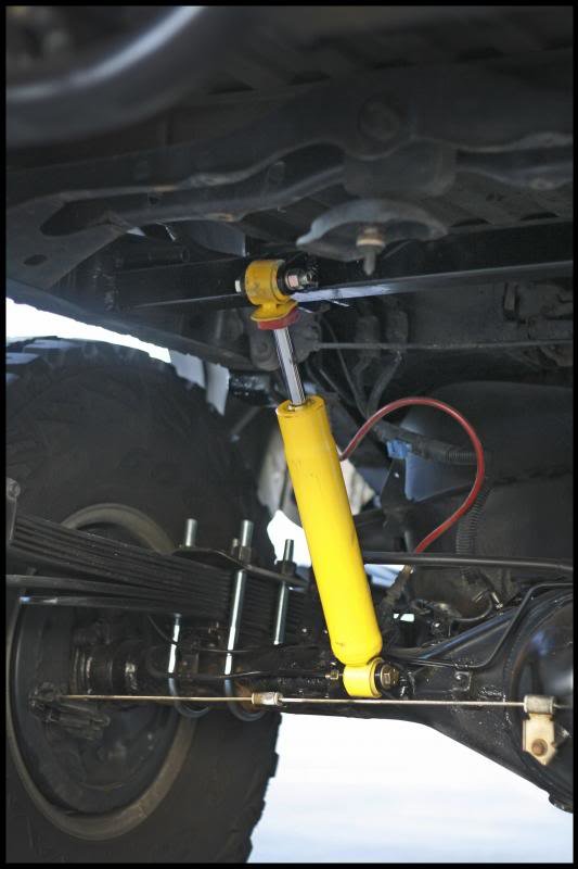

    I finished up my ubolt flip over the weekend. This included a rear shock relocation and install of axle relocation plates. The relocation plates definitely help center the wheel in the fenders better.
    getting the shocks in the right spot for optimal travel has been a little tricky. Long story short the OME nitrochargers just won't allow for the complete range of travel possible with the Dakar springs. You will either limit compression travel or droop.
    I'm making some final tweaks tonight to the upper shock mounts, but mine will have a bias to allow more droop than compression. Pics to come shortly.

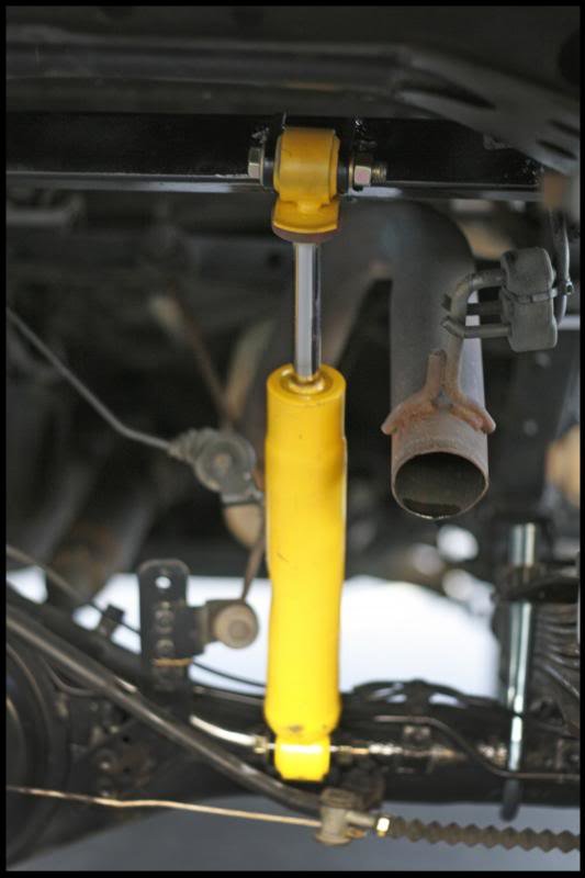

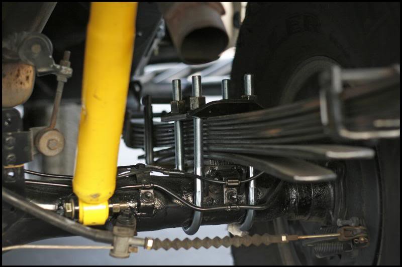

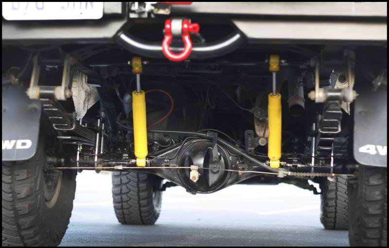

    Pics of rear shock relocation.
    after some tweaking I think I ended up with pretty balanced travel from the 10" stroke OME shocks. Right about 5" of travel in droop and compression. I'm using the whole shock for sure and with the position of the shocks I'm getting a bit farther drop than I was in the stock location.
    It rides a little different (not bad just different) with both shocks angled to the rear. I'm still on the search for some replacement shocks with just a bit more range of travel that are the right length. This setup will work for Moab and until I find the right one to replace the OMEs
    Welded in a new crossmember directly underneath the the upper mount on the driverside.
    TG ubolt flip was straight forward. However, with the spring relocation plates (can see them between the spring perch and spring) the hole in the ubolt plate didn't line up so I had to expend the hole in the plate. So anyone doing the TG ubolt flip in conjunction with spring relocation plates, be prepared to modify the ubolt plates with a larger hole for the center pin. I moved my axle backward 3/4" and it seems just right. The plates allow for 3/4" or 1" of movement in either direction.
