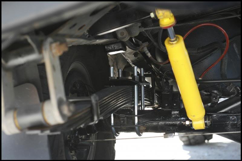

    ome Dakars in rear and ome 882's in front. 255 85 16's maxxis bighorns
    so on my truck with my dakars when the driver side is compressed the military wrap makes contact with a line, in your fourth picture you posted it looks like it does the same thing have you ever noticed this? if so has it proven to be a problem wearing through the line? also disregard my question about the relocating plates I read through the end of your build thread and noticed you did get it installed, I will do the same on my truck being it seems to help everyone that does it. thanks

    eh....no idea what you're talking about here. What is this "line" you're talking about?

    ill post a pic from my truck in a little bit...

    you can see just slightly where its been rubbing under full compression (the line that paralells the gas tank)

    Well after I got out my microscope to see those pics, I'm assuming you're talking about the parking brake cable. hard to see where it's rubbing though.

    ya, that's it. its in a bracket right next to the gas tank, it rubs the military wrap under full compression, does yours do this as well

    That isn't the military wrap. I think you're talking about the spring clamp. The military wrap is the second leaf of the spring that goes completely around the forward spring eye.

    ahh I gotcha, does the spring clamp rub on yours as well then?

    Don't think so. Shouldn't be a big deal if it's not tearing through the protective sleeve.
