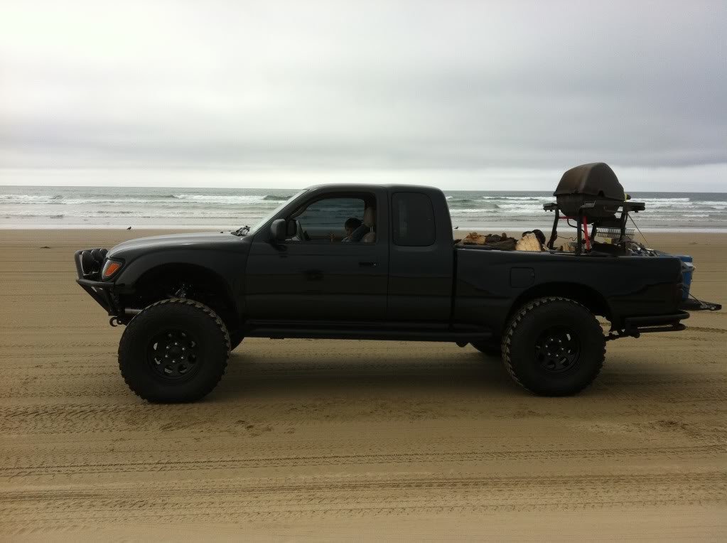

    this

    lets go with that. looks good enough. where do i acquire such a device? home depot?

    Topper shop for sure.
    I think I have 4 extra ones buried in my garage somewhere too.

    remember that whole paypal thing we did? wanna do it in reverse order lol :anonymous:
    so you think those would hold on my bed rack alright?

    Haha! I'm a RedBull guy. Monster is for d-bags.
    Just bolt it on. I take my rack on and off all the time and it's held on with 8 bolts. Takes maybe 5 min. It will take you just as long to loosen clamps as it will to take out a few bolts. Clamps are not going to be nearly as secure.
