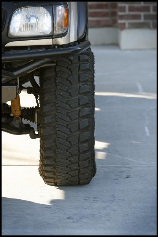

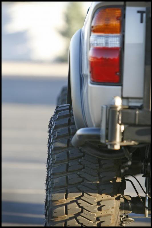

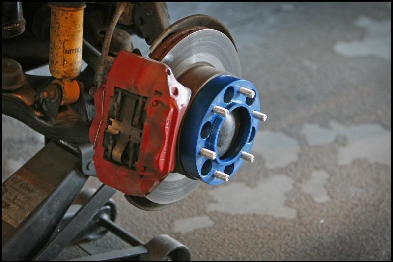

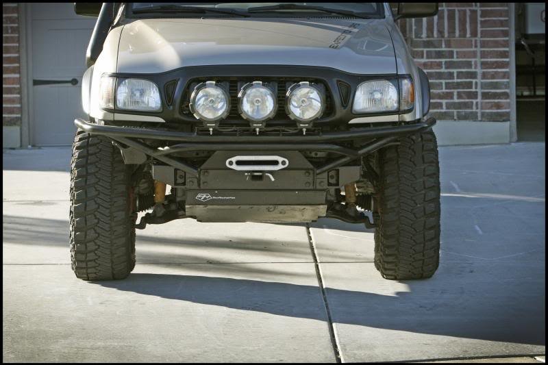

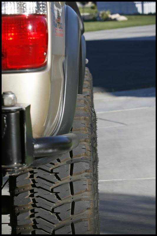

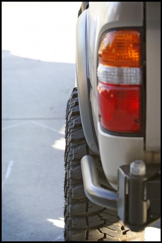

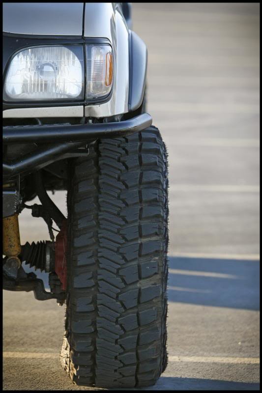

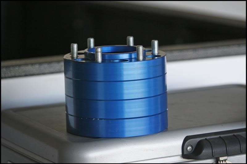

    Bit of a photo dump.
    Installed some 1.25" Spidertrax wheel spacers tonight. Main reason was because the front tires were rubbing the frame at full lock. Spacers fixed that. Stance is definitely wider and I'm sure when I get in the dirt it's gonna throw more crap up the sides of the truck but oh well.
    I'll try to put before and after pics together from the same angle so you can see the difference.
    Before:
    After:
    Before:
    After:
    Before:
    After:
    Before:
    After:

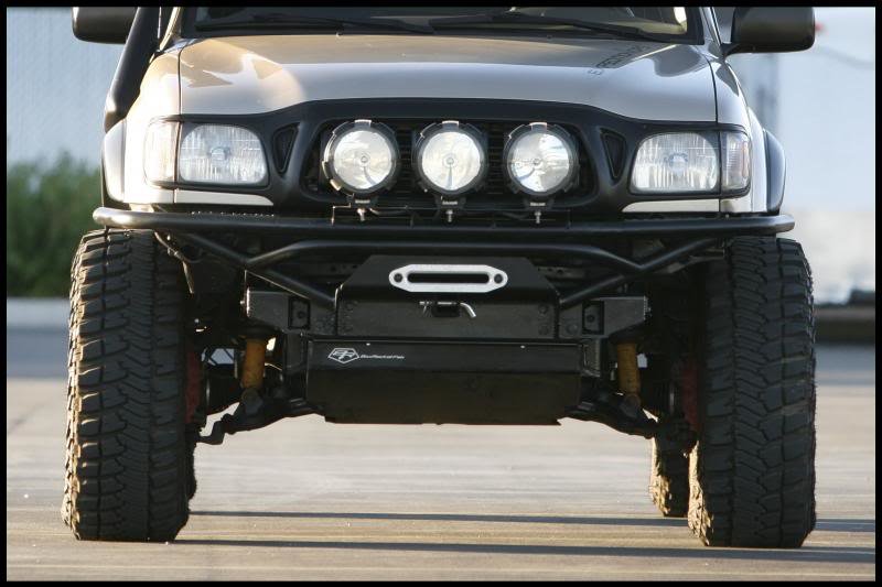

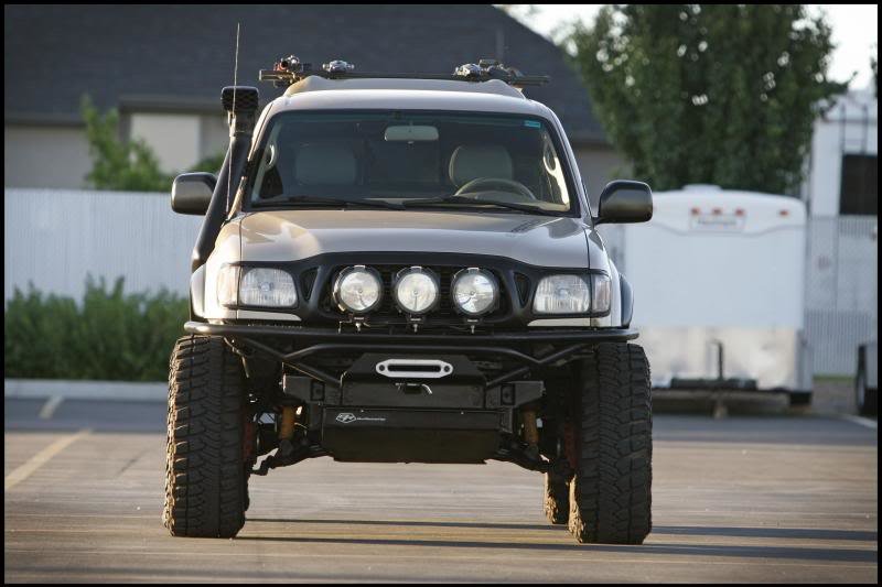

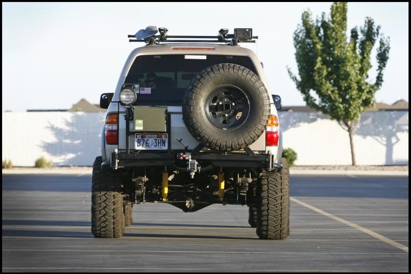

    A few more afters
  7. Jun 27, 2013 at 10:53 PM

  8. Jun 27, 2013 at 11:00 PM

    Custom body work/damage ARB rear locker Bumpers Shocks Other parts Tires and Rims Air tank fully plumbed into truck "Golf ball mod"
    A surprising amount of difference! Looks a bit more aggressive!

    Looks great! When I put my 1.5 allpro wheel spacers on most definitely more dirt on my truck. Gives your truck a great looking stance.

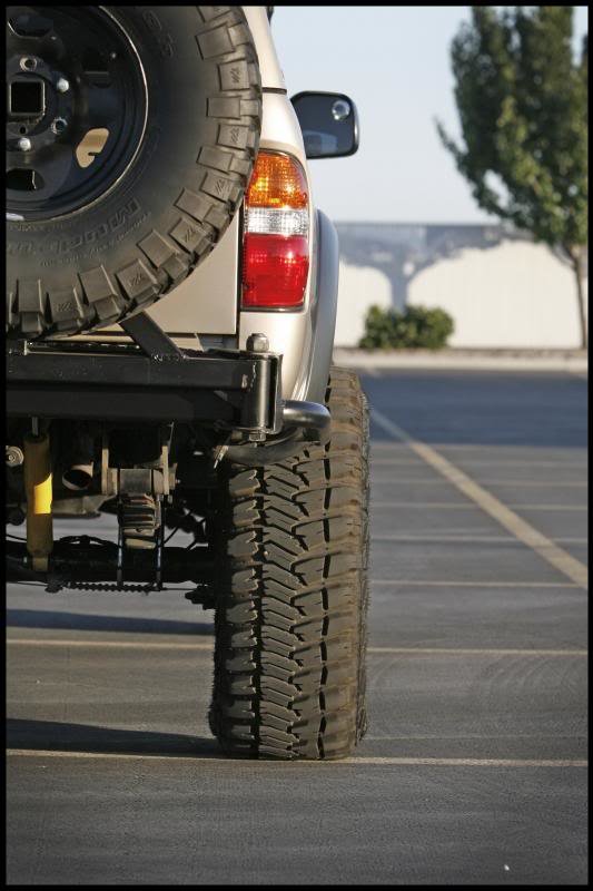

    looks great adam.. i feel like you're almost at my stance now, gotta be pretty dang close(best pic i could find)

    looks good, are their any negatives to wheel spacers?

    i have been considering spacers as well because I rub on my frame and sway bar at full lock. the negatives i read are just additional wear on components and possible "heavier" steering.

    One of the most major negatives is that it will cause more and faster wear on your wheel bearings and steering components but that is all i'm aware of. I love my spacers and considering it saved me close to 1K over buying new wheels it was a plus.

    also, new wheels with less back spacing would also have those effects on parts wear so it's a win win.

    I can attest to the heavier steering. Also steering radius is reduced.

    I've heard most the wheel bearing issues are 2nd gen stuff. Hell I rolled my truck with mine on and they are fine ha been running them for 3 years now.
