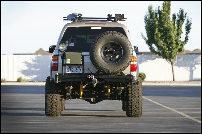

    Yeah the wheel spacers add strain to the wheel bearings but periodic maintenance of the bearings can help. There is a slightly "heavier" steering feel but personally I like that. Feels a lot less twitchy.
    Also anyone considering wheel spacers needs to be disciplined about keeping the nuts torqued. Using loctite is great but you shouldn't just throw on some spacers and never think about them again. Just double check that the spacers are torqued correctly once a month or so and you should be fine.

    X2 and make sure to use a torque wrench. You don't want to over tighten them.
    And I always recommend extended thread lug for the front. Cheap insurance and hold the torque much better on our already very short front wheel studs.

    bora is having a GB. maybe I should hop in on it... I like the stance, but I wonder how much worse rubbing will be?

    Rubbing goes away for the frame. But the wider you go the more you'll have to cut from the fender.
    Not sure what Adams BS was on his rims. But I'd guess right now he is sitting at 3.5-3.25. I'm at 2.5" and had to trim the fender a lot more then when I was at 4"

    I like this one! Stance looks way better, Adam...

    Adam are you running 1.5" spacers ?

    thanks man searching on my phone sucks and lol didn't realise that was a page back! with that being said I guess, did you have to do some nice cutting on your fender and what backspacing did you end up with

    I install spacers the same way I do the wheels, (no specific torque ft/lbs, no locktite) never had a problem. YMMV :notsure:
    The only thing I didn't like about running spacers is that they make changing the CVs a huge PITA, especially when you're working by yourself.

    looks mean adam..i like it
    any laws by you regulating the amount of tire that can be exposed outside of the fender?

    Yes. Techinically the entire tire needs to be covered by the flares, so I'm a bit "grey" with the legality right now. However there are a lot of full size trucks driving around here that are MUCH worse and don't seem to get hassled too badly so I'm hoping it doesn't draw too much attention.
