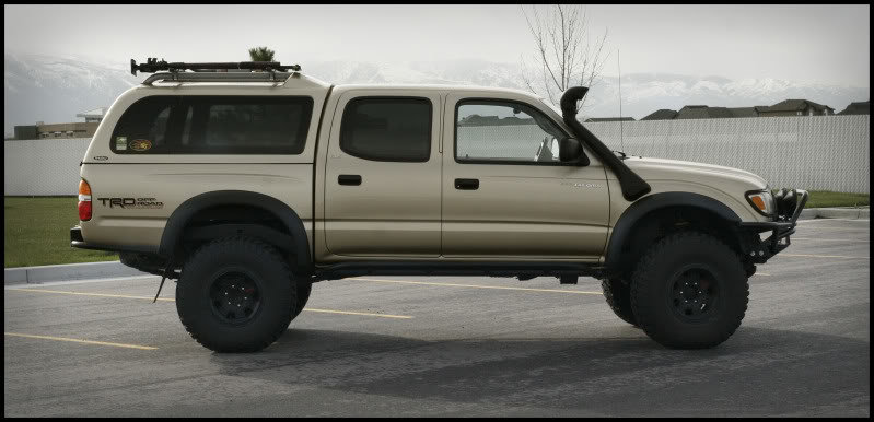

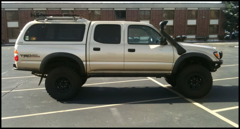

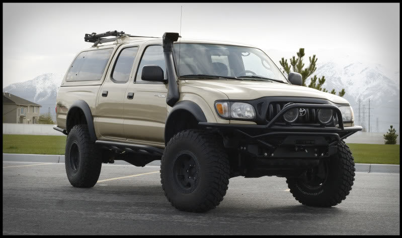

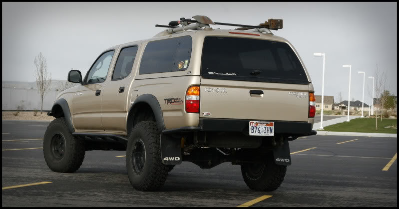

    I installed new OEM rotors and pads earlier in the week and also found some time over the weekend to get the new OME D6XL AAL added to my Dakar spring packs. Currently looks like an additional 1.5" of lift, but that will probably settle some as the spring breaks in. I can already tell the load handling will be better. The rear of the truck feels much more sturdy and planted. From the drive to work today I can't tell much of a difference in ride quality. That might be different in the dirt, so we'll see. Install was simple and thanks to Kurt at Cruiser Outfitters for the parts and some good tips on the install.
    For anyone running the Dakar springs you've probably found that they don't handle much extra load very well at all. This D6XL (1st-gen) AAL should give a dramatic improvement in load capacity.
    before. Dakar rears, and AllPro 1.5" shackles
    After. Dakar rears, D6XL AAL, AllPro 1.5" shackles. it's also worth pointing out a slight weight increase in this photo from the before photo. In the after photo, the spare tire is back under the truck, and although minimal weight, the shovel and hilift have made their way onto the topper rack. So maybe 100* additional weight over the before photo.

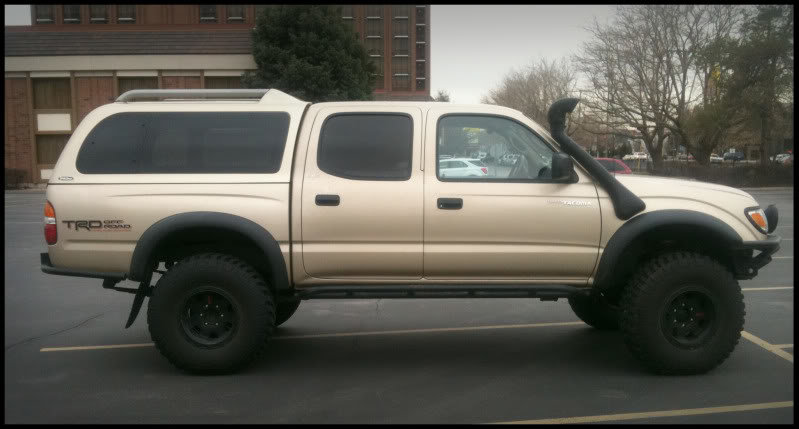

    You mean like this? Been there done that. 16% tint. Had it for about 10 months before I got tired of it.

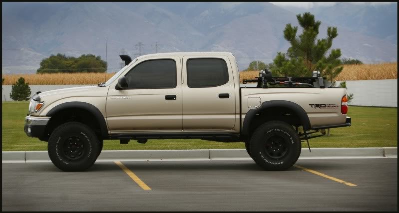

    Yes, that last pic was early last fall with worn out 32's. Currently has almost new 33's

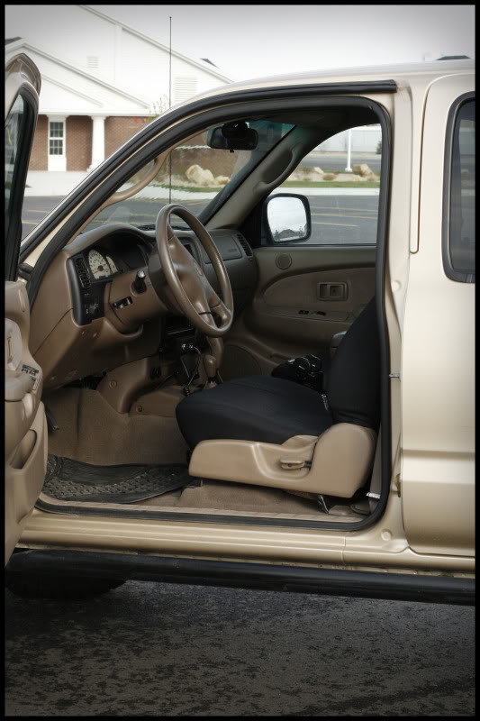

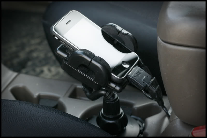

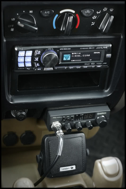

    A few updates. First, a couple older interior pics I've forgotten to post up.
    Alpine Deck, Uniden CB/ext speaker
    Scosche iPod/iPhone bracket that is tension mounted in one of the cupholders
    Not a great photo, but I found some 'cheapo' seat covers at Autozone. Came as a set with both fronts and one for the rear seat. Overall pretty good fit for some generic off the shelf covers.

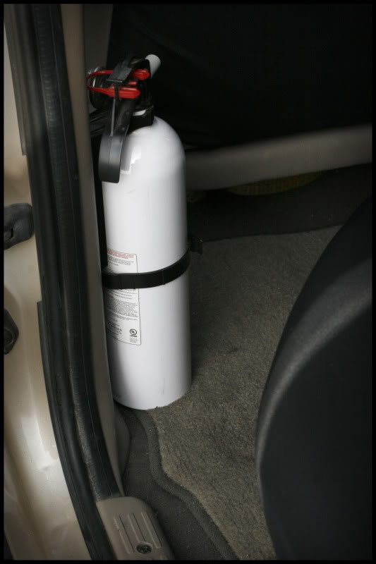

    Fire extinguisher behind driver seat in rear passenger footwell

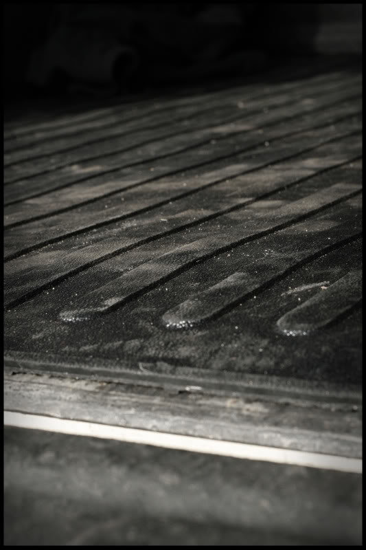

    Found a sweet deal on a DeeZee bed mat. It was for a fullsize but I just cut it to fit. Nice added protection for the bed (even though its already lined)

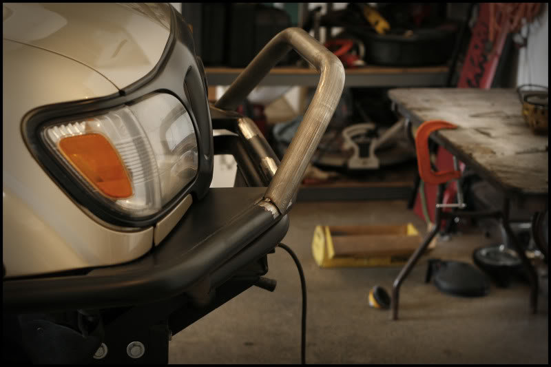

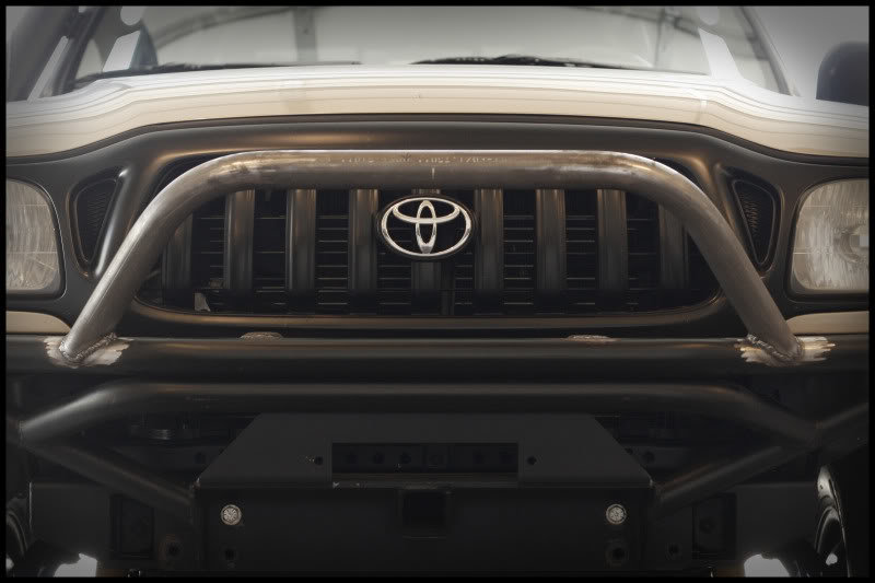

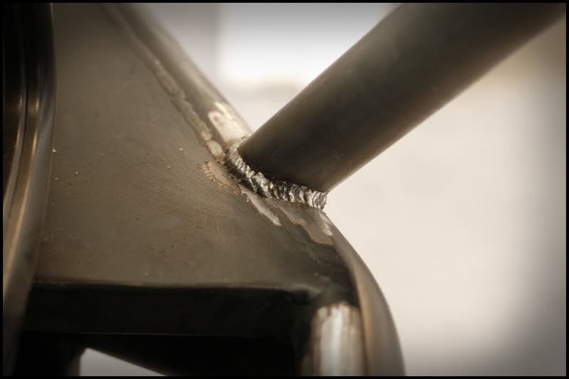

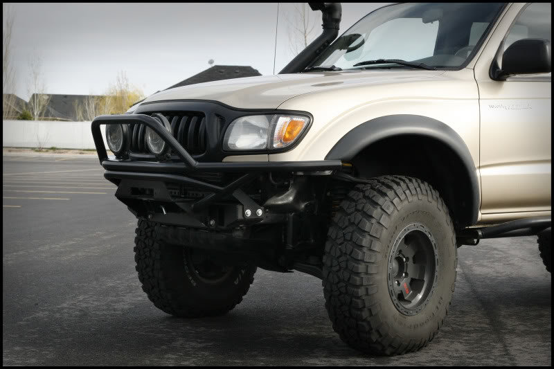

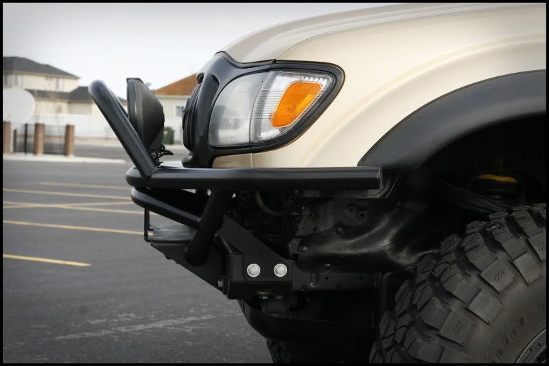

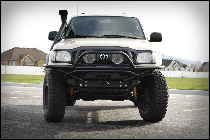

    Next up. I got the Trail-Gear lightbar welded up and painted on the Trail-Gear Low Profile bumper.

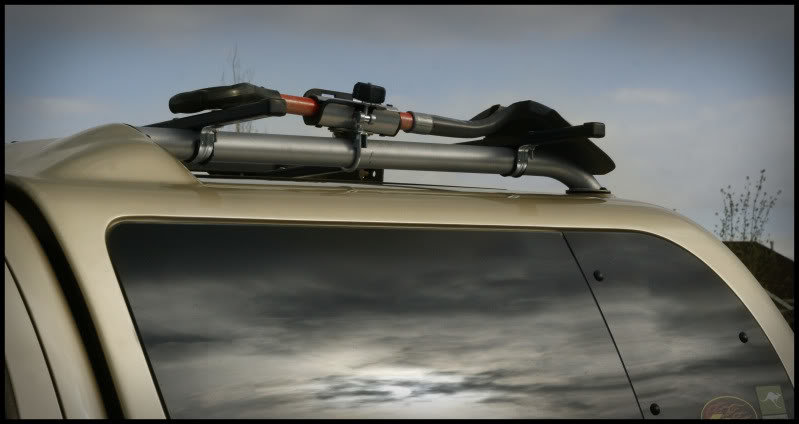

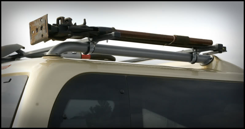

    I've also meant to show some better photos of the SnugtopXTR and a couple simple mods I've made to it.
    First I used some 2" conduit brackets to attach a couple of the extra Thule load bars that I had lying around.
    Then I used a Swagman Bike clamp with a ubolt to mount the shovel.
    Couple more ubolts and the Hilift was mounted on the other side.
    Now just a few photos (hopefully better than the cell phone pics I posted earlier) of the top.
