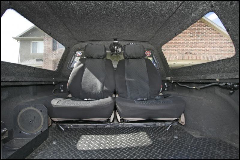

    This is one of the ideas I used in my truck. Seating for 4 in a single cab. Plus I just might leave my camper on and put an internal cage for the kids

    I have no doubt you have the safety of your boys in mind when they're riding back there... is it just a lap belt for a seat belt? And is there enough air flow back there?
    Also, is there anyway to securely mount a couple of "oh shit" handles for them?

    I'm working on figuring out some grab handles. Air flow is good. We just open the windows from the cab into the bed. The side windows of the shell open too.
    Seatbelts are just lap belts. No different than the middle seat in the back of a double cab.

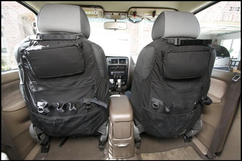

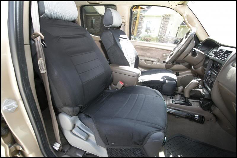

    I got a few more questions about my seats so I snapped a few better pics. As a refresher I swapped in some front buckets from a Suzuki Reno. The were pretty inexpensive from a junkyard, and suprisingly comfy with much better side bolsters than the factory seats. I'm using some Smittybuilt Carryall seat covers. These have worked out better than I would have thought. I like the pockets in the backs and they get used constantly to hold a variety of stuff on trips.

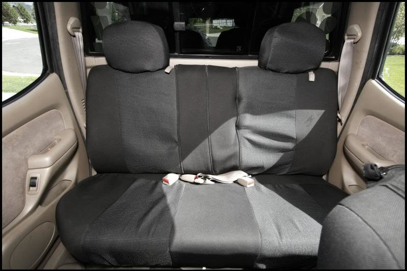

    I picked up a seat of cheap seat covers from Autozone that I use on the rear seat. (came with covers for two buckets and a rear seat). I use the two bucket seat covers on the factory seats that are installed in the bed.
    Rear seat.
    Seats in the bed. These are factory seats welded to a custom seat frame that is bolted through the bed floor with large backing plates. Both seats have lap belts. I also have a fan to pull cool air from the cab into the bed.

    What kind of fab work was required for this?

    Adam, is it my eyes, or do your factory buckets tilt inwards?
    My seats actually tilt inwards as well, pretty significantly. I thought it was a result of the beating I put my truck through.

    Not much. The Suzuki seats had sliding rails that were the same width as the factory seats. So I cut the mounting brackets off both sets of seats and welded the factory brackets to the Suzuki seats and they bolted right in.
    I'm pretty sure it's just from the wide angle lens I used. They're pretty straight.
