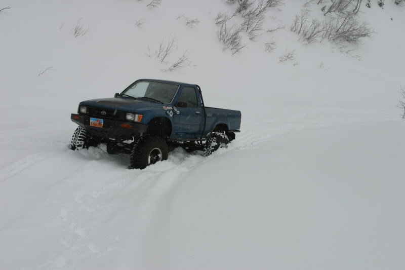

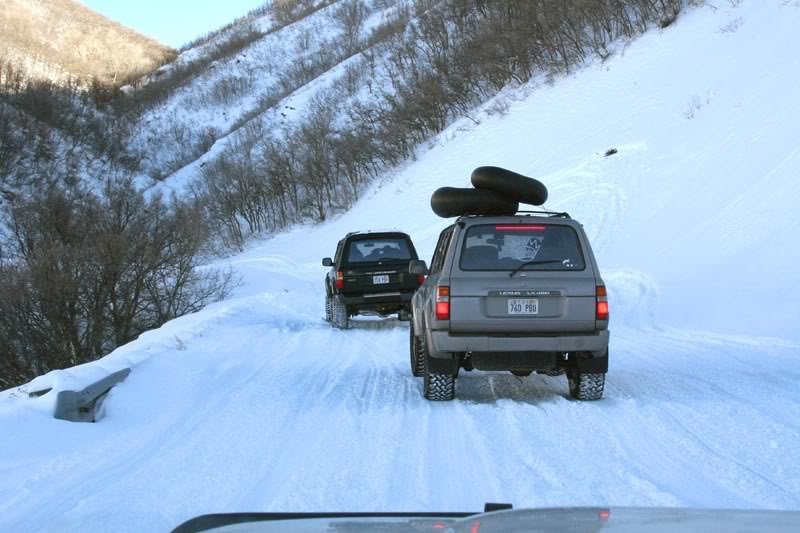

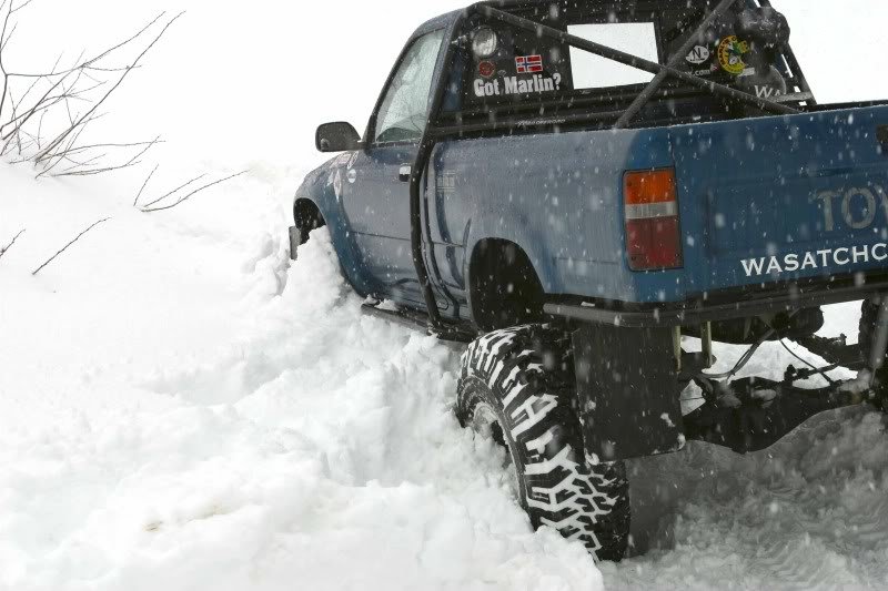

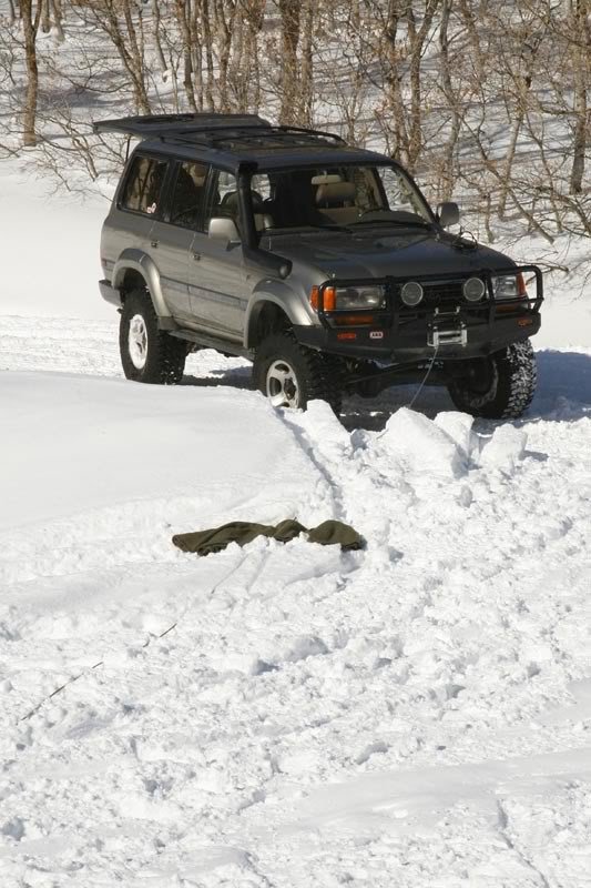

    It's nothing technical. Skyline Drive is a grated dirt road that can your grandma can drive in here Honda Accord in the summer time. The snow is what creates the challenge in the winter time. We've been doing this un off and on for the past 14 years and nobody has been able to get to the top of the road yet. As of right now there is not quite as much snow up there as there normally is so maybe we'll have better luck unless we get more snowfall between now and the 11th.
    It's not a run that should cause vehicle damage, but plan on getting stuck and needing to dig/winch yourself out at some point.
    Here's some pics from past trips.
    there are 37's buried in there somewhere
    35's, SAS, fully locked, dual cases.....none of which helps much when it gets deep
