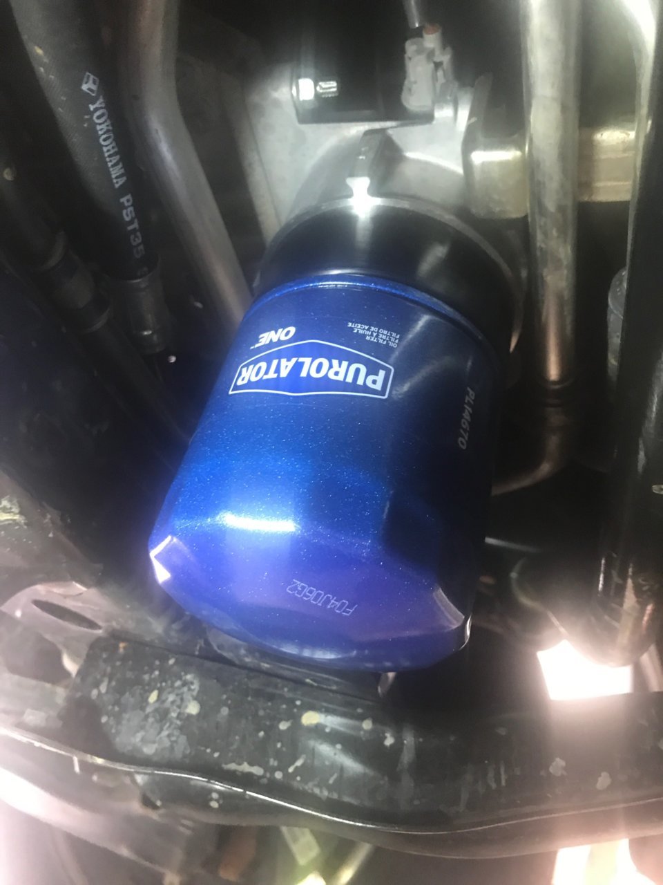

    I have the spin on adaptor on mine and I’m happy with it.

    TS-101-BK
