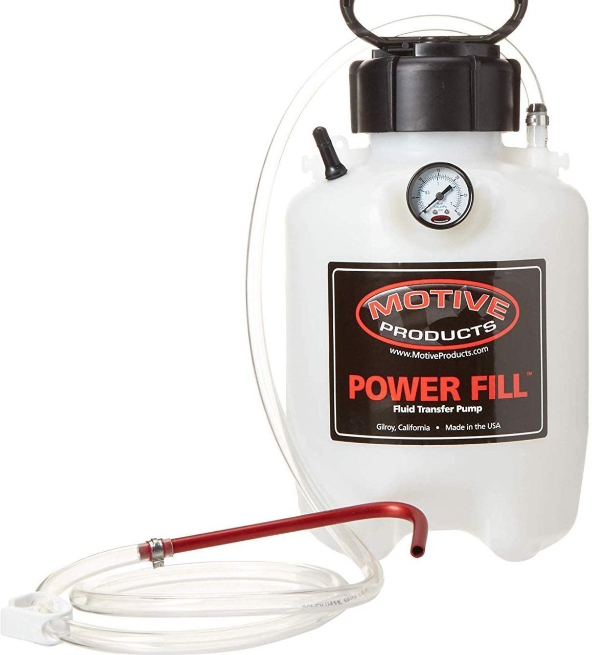

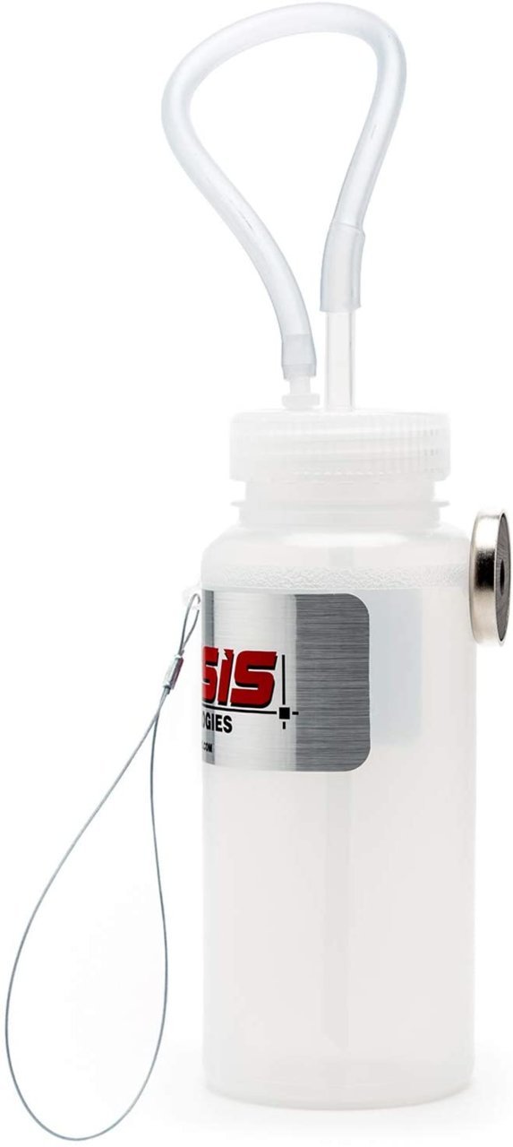

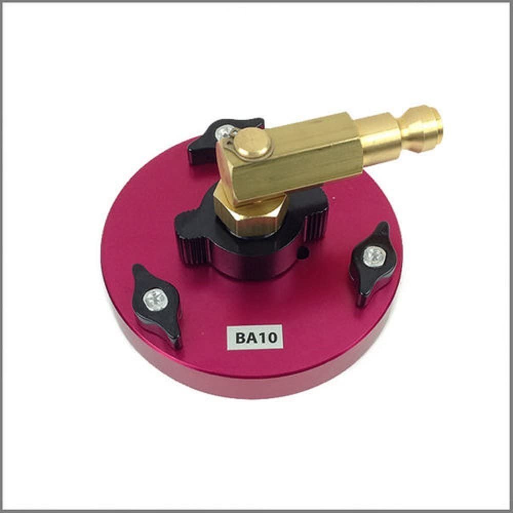

    Its always nice to have the additional hands but when you don't....necessity is the mother of invention! I cobbled a few items together that I can use independently for TC, Rear Dif, Front Dif and Transmission
    fluid drain and refill changes, as well the bleeding of the brakes without "extra hands"
    All that is required are a few additional air line fitting and a shut off valve and you are ready to go...with very little investment.
    Items are as follows:
    Motive Products 1730 fluid transfer pump.jpg Bleeder Bottle.jpg Power Probe BA10 Small Adapter Toyota.jpg
    Enjoy....
