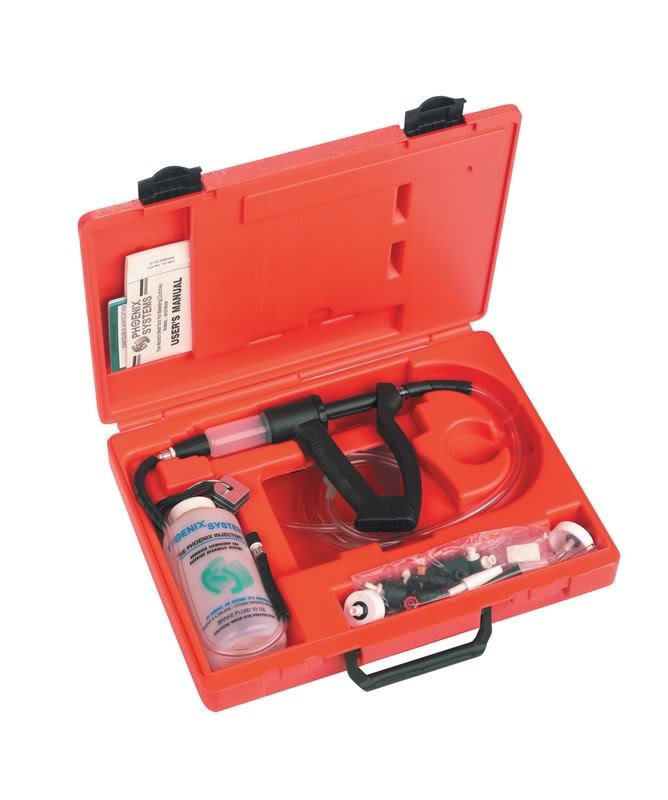

    I am trying to bleed the brakes on my 97 Tacoma (non-ABS) and having a hell of a time with it. I put new rubber hoses at both calipers and the rear and a new master cylinder on. I've bench bled the master cylinder 3 or 4 times, used an air compressor vacuum bleeder, and spent about 2 hours of pedal bleeding. I can not get fluid to come out at any corner of the vehicle. What am I doing wrong? :confused: Oh, and I just bought one of these: v12toolkit_f8616f7fd43571a10b8b0ab764e9e2bb7802b4a4.jpg

    Okay, I just got the tool today and have to say it was worth every penny. I drained and flushed the clutch out with it and the pedal was solid. I had my friend work the clutch pedal afterwards and bleed it the usual way. He said it made no significant difference in the stiffness of the pedal. Which means that maybe this is the one and only "one man brake bleeder" worth messing with. My brakes are another story though. I put on another rebuilt master cylinder after bench bleeding it with my new tool. I checked the clearance between the actuating rod and the master cylinder piston. I then flushed the front and rear lines until fresh fluid came out the other side. I filled up all the lines using reverse flushing method and had a solid pedal. I decided to have my friend work the pedal so I could get any possible air out. The pedal didn't seem to get any harder. With him holding the pedal to the floor, I could easily turn the front rotor with my bare hands. Strangely enough, when I started the engine to see if they worked any better with some vacuum boost, the pedal had no resistance at all. It literally went to the firewall like there was no fluid in the system. Any ideas?:confused:

    Well, after being undrivable due to many different conditions, my truck is finally back on the road. My brake bleeding problem ended up being 2 bad master cylinders. I had bought 2 rebuilt Cardone brand master cylinders and neither of them was worth 2 cents. I bought a rebuilt one from Napa and it did the trick. Got a good and solid pedal now and a big weight off of my shoulders. My truck was out of service for 84 days! Whew! :D
