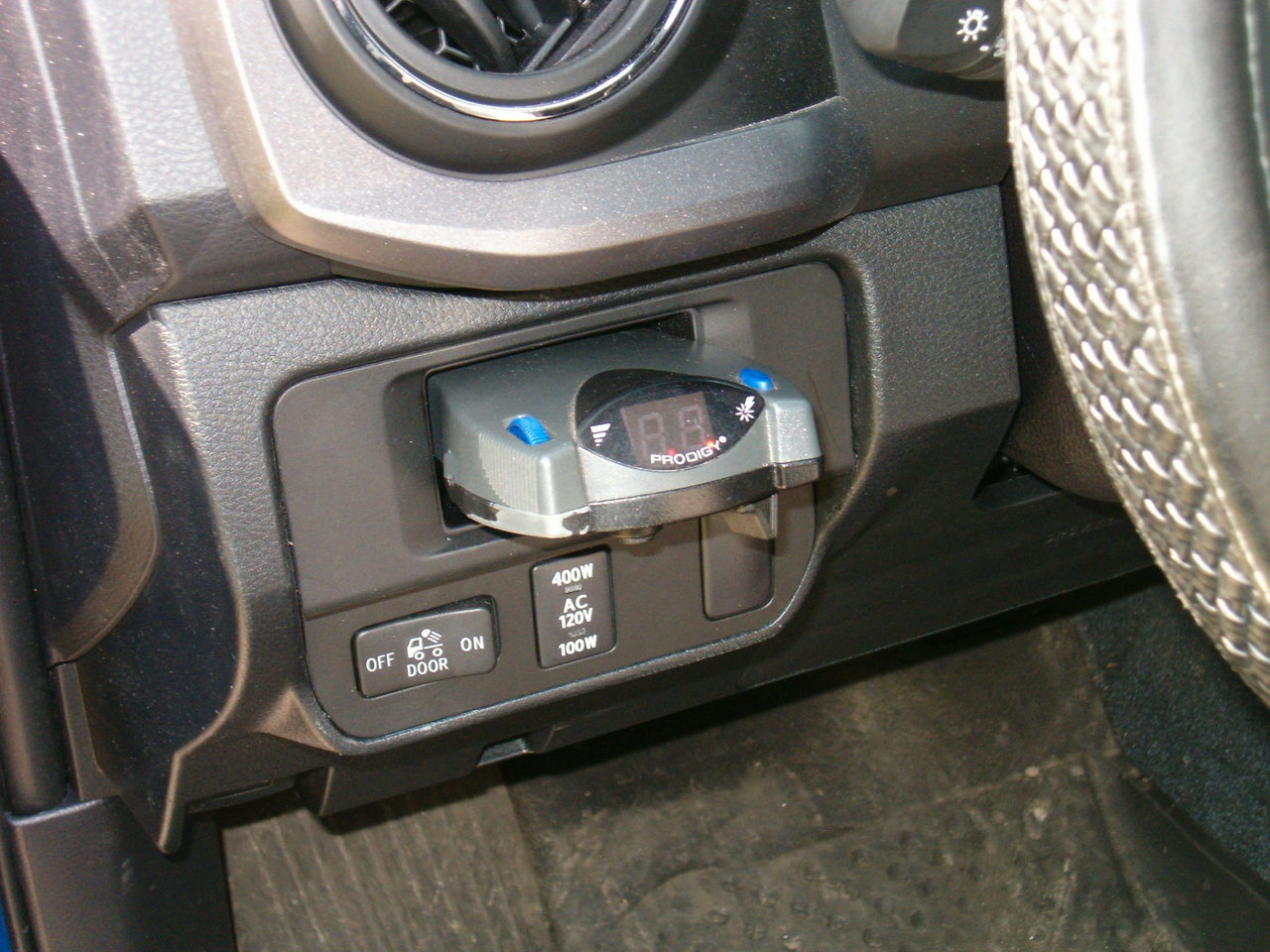

    What brake controller fits into the slot on the left side of the dash cubby hole

    If you need to take the lower panel off to run the cable, there are 3 screws along the bottom then a bunch of snap in clips that hold the panel in place. they also surround the SRS module below the steering wheel. they are hard to re-engage when you are putting the lower panel back in place. I took the upper trim peices out when i did mine but i don't think you need to. If however you do, lots of youtube videos on the process.

    I fit my prodigy p2 in there. Doesn't look super oem. But it works, and I plan on taking it out over the winter when I'm not using it

    Stock TRD OFF ROAD DCSB AUTO JBL TECT. Bed Mat Heated and turn signal mirrors Wet Okole Front Seat Covers Prodigy Brake Controler Front Skid Plate Power Wagon Badge Tint Driver and Pessenger door windows Inchannel window vents

    I still need to do this. I hate how the p2 looks in mine.

    The p3 fits too.

    If you do I would recommend going on the left side of the panel instead of the right like I did. Not a huge deal, but hard to see behind the wheel.

    Thank you sir! Plan 'A' currently is to use a switch blank in one of your switch panels. It seems like the control dial would fit in one?
